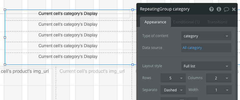

Then I set a workflow on the Displays, because I want to link to another page, and send the category that was clicked in the option set. (This seems like a natural thing for an RG?)
In the workflow, I tell it to go to another page, and send the category data. But it is asking for more info, and I’m not sure what I’m missing here?

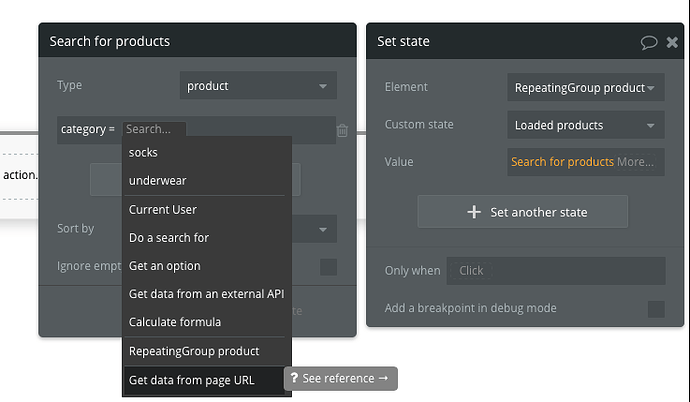

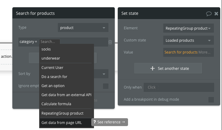

Now I am trying to get the browse page to read the parameter. “On page load” i’m setting the state of the RG to be a search for products, where the category = the category parameter from the URL.

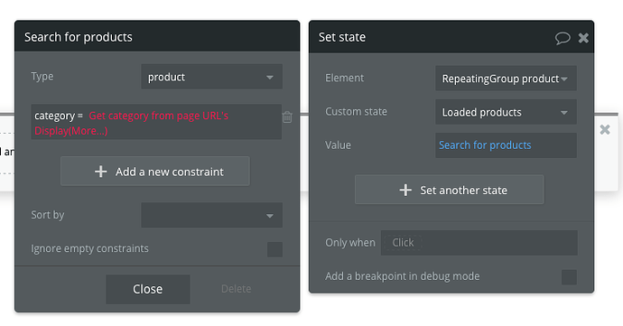

But it’s still not letting me just use that logic, and it wants me to use a different syntax somehow… Can I not just say that category = category’s display?
If you are sending something in the URL it will be a text. If the category data type is not a text this may be why this isn’t working? Alternativly you can try removing the display so it just says ‘Get category from page URL’ this may work.
I had to set the category parameter as the category option set. I had previously set it as text, thinking that since the URL parameter was text, that is how it would match, but nope! Thanks for prompting me to take another look at it.
