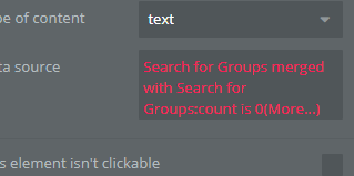

Thank you once again. The merge with allows the first Search for constraint (Going contains current user), but then the next Search for constraint gives red error.
merge
What does the issue checker say?
From the screenshot snippet you’ve included, the box looks like it’s the type of content for an element, but instead you’ve included a formula for evaluation. That type of formula would need to sit in a condition or the “only when” box in a workflow.

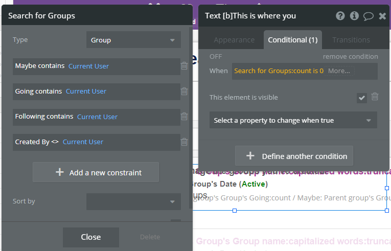

But, there’s a new issue in that only one merge with function can be used, it won’t allow more. So I have set up the condition like below;
You are looking at the settings for the first Search for groups condition, where you see the second Search for groups condition I have said Created by <> Current user.
Anyway, none of this works, presumably because (as you said) I am doing an “and” search instead of an “or” search.
I am stumped again!
The box you screenshot in yesterday’s post is different. You had it in the wrong place the first time.
You can use multiple merged with. Try it again.
Based on your screenshot, it looks like you are still putting 3 conditions each search. Only put 1 condition in each search (except for the Going search, which will have create <> current user).

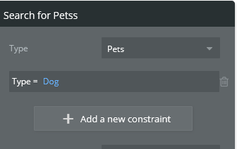

The above merges 3 searches. Here they are:
First search:

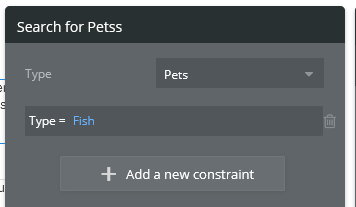

Second:

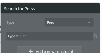

Third:
