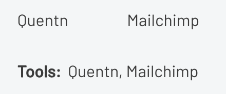

Bildschirmfoto 2022-08-01 um 12.36.38
First row is done with a repeating group. Second row is what I want to have.

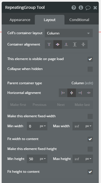

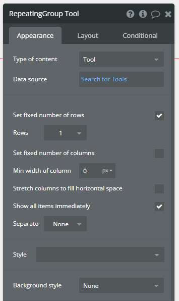

Have a RG with the following settings:

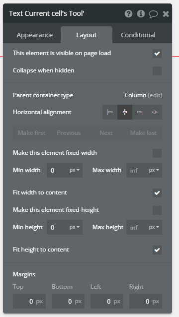

Add a text element inside the cell:
And here’s what you get:
Just add a workflow on click of the text within the cell to run whatever actions you need to run.
Fantastic, I must have had something wrong in the layout setting. Now it works. Thank you.
