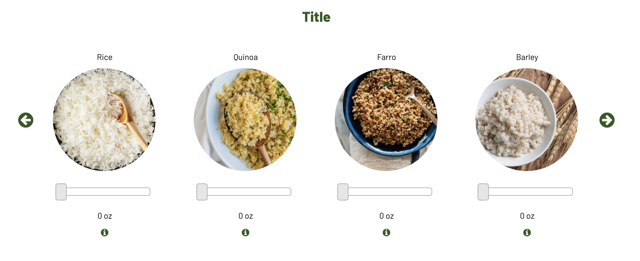

Alright, here’s where I’m at right now.
Horizontal Scrolling:
When I use horizontal scrolling, the formatting is weird (notice how the fifth element is cut off part way). Also, there is not ā€œinfinite scrollingā€ like a carousel, which is not a necessity, but makes it less awkward. The one thing horizontal scrolling does right is save my slider inputs, so when the user scrolls, the input is not reset.
Fixed Cells:
When I use fixed cells, the formatting issue goes away, so only four elements are shown. However, when I press the arrow, my slider input is reset.
Basically, I need a combination of the two that (1) formats correctly and (2) keeps the slider input value. I did try using the ListShifter for horizontal scrolling. It corrected the formatting issue and created a carousel, but reset my slider input value. Any ideas?
