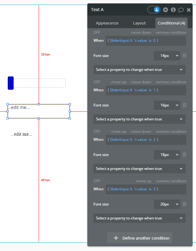

Hi all, I have what I think should be a fairly simple query. I have a slider with a range $0-100. Once they adjust that range (ie. they’ve touched the slider) I would like to change the size of the font. I’ve got as far as the input for range (see the attached screenshot) but haven’t got a way to add that to the expression.

The main problem is that font-size is not dynamic. That’s why if you want to use a regular textfield, you should set the conditionals for some ranges in the slides and assign font-sizes manually. OR you can use HTML to display some text, and it will be easier to assign dynamic font-sizes. See demo below:

The first one is a regular text field with these conditions. I set only the first few values of the slider, that’s why it doesn’t get any bigger, but you get the idea:
And the second one is an html element that shows some text and calculates font-size dynamically. Easier of course:
And here is the editor if you want to check more details:
