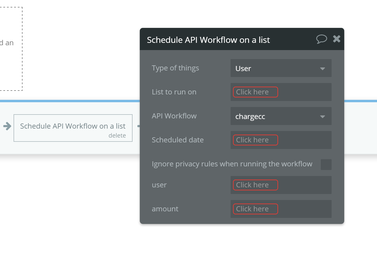

  6. now in your main workflow when you schedule the charge you should create an action that’s called "schedule an API workflow on a list of things (see the next screenshot)
  7. you will need to define the list of users that have to be charged. Also you need to pass the amount parameter (Which can be static or dynamic). The only thing that I’m not sure of what to pass as a user parameter here. I thought maybe we should remove it but then the charge CC action cannot refer to a user. Maybe @emmanuel could help here?

Thanks Levon! I am storing all of the Amounts in another table, different from the user table – let’s call it the “pledges” table. One user could have multiple pledges for one product. So could the “List to run on” search for the sum of all pledges submitted by the user being charged?
I think it would be useful to walk through all of this on a Skype call. What do you think?
Hi Keith, seems like I figured what should be in the user parameter - it should be “this user” and yes, I guess we could sum up all the amounts for each user. I’ll send you a DM now to schedule a skype call.
