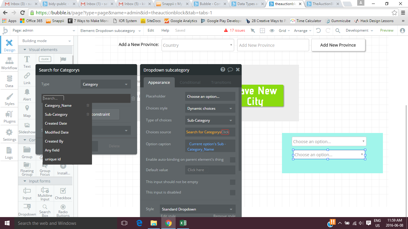

And here is the subcategory dropdown which I am stuck on.

No worries at all! Data structure just needs practice. Ok, you’re so close. Category is right. Subcategory… change choices source to “search for category’s sub-categories” and set a constraint on the “search for categories” -> unique id = dropdown 1 value’s unique id. Now, we’re only looking at the sub-categories of dropdown 1’s category selection.
EDIT: Oh an alternative way just came to me - for choice source: “Dropdown 1’s value’s sub-categories” That should work too.
I don’t seem to have the choices you mention.
Am I missing something or?
Missing a few things -
EDIT!!! First, for choices source - keep clicking after “search for categories” not in the new search window that pops up on the left, just within the same input so that it reads “search for categories’s FIRST ITEM’S sub-categories”.
Alternative for choices source: “Source = Dropdown value’s subcategories”
Second, in your search constraint window - You’re very close. Type is category, correct. Unique id = dropdown category’s value’s unique id (keep scrolling down to get to the unique id option)
