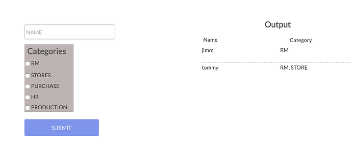

I need to save the multiple checkbox values to the bubble database once I click submit. In the below example, I am unable to save the exact values of the check box If select multiple categories.

Hey @samuel, are you referring to β€œSTORE” instead of β€œSTORES” ? I updated the workflow where you create the STORES value, it was just missing the S.

Please try with below Example
1st data entry:
Name =ABC
Category=RM
output will be ABC RM
2nd data entry:
Name=XYZ
Category= HR and STORES
the output will be XYZ RM,HR,STORES which is an error
the actual output should be XYZ HR,STORES. whereas in the above case RM is also getting added to the record.
Fixed, you had to clear the custom state when the Submit button is clicked so that you can reset that value. Take a look, the value is just blank when Submit is clicked.
