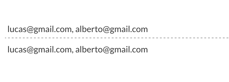

Hello guys, Ive been having some difficulties with something I believe is quite an easy fix. I
ve created a multiselect dropdown that displays 3 types of “habilities”. An hability is chosen and a repeating group on the same page should show all the users that have these habilities (habilities is a field within Users). However, every line on the repeating group shows all the users repeatedly. I would like to make each line show a single user. Ive tried “unique elements” but it doesnt seem to work for some reason.

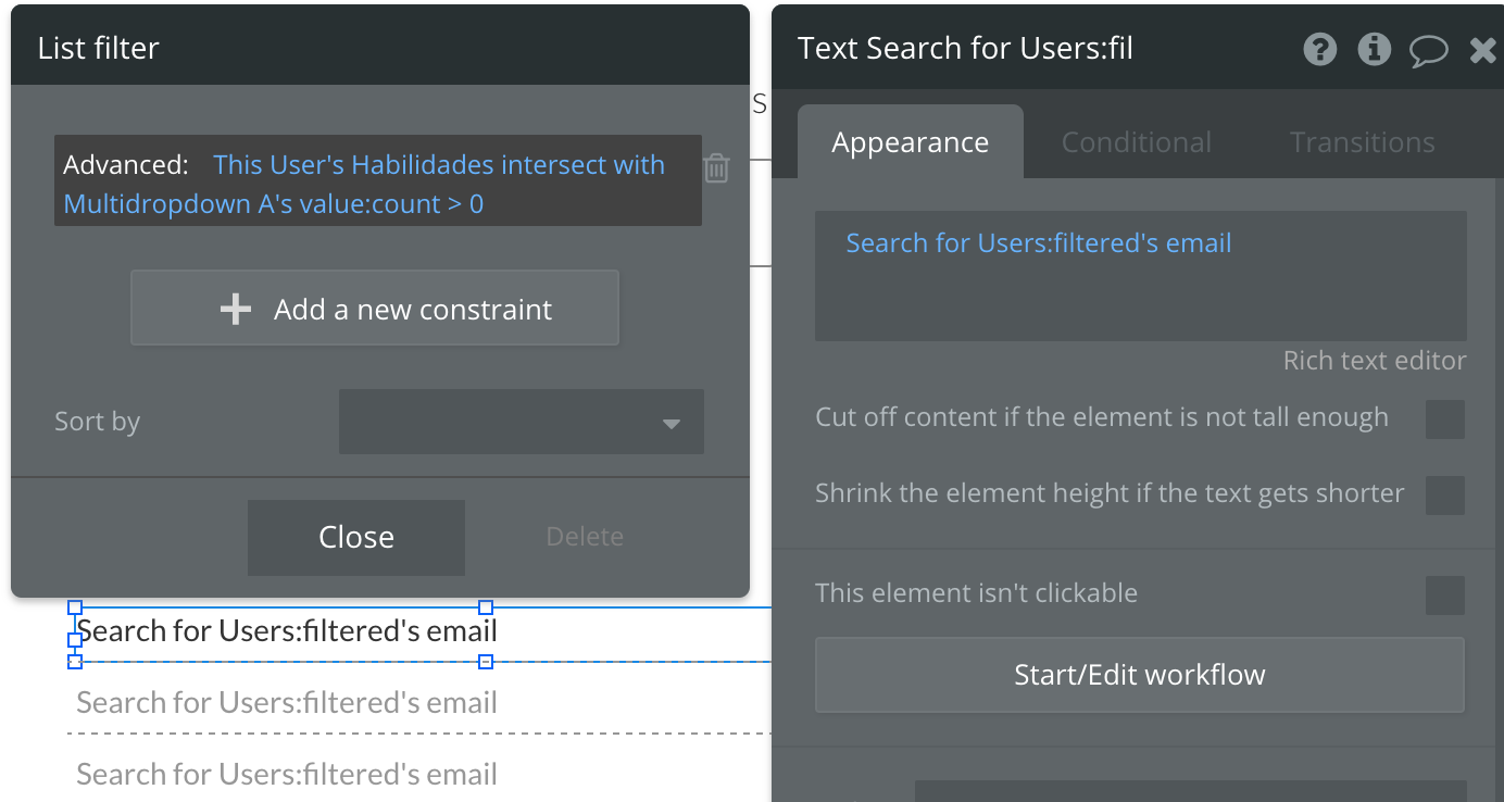

This is what my repeating group looks like

This is what I get:

Anyway the reason why every line in the repeating group is showing all users repeatedly is because you’re wrongly doing the search on each line. You should rather return the search of users to the repeating group. Then in each line of the repeating group you just display Current Cell’s User’s email.

Thank you for the help and the demo! Problem solved perfectly in 2 minutes hahaha
You’re awesome
