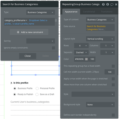

I am then using a repeating group to display the different categories against the business profile, however, each category is on the same line, e.g. not being treated as a separate list entry. See below, I hope this makes sense…
I can get the query to work, as in pull the data, but it’s all on one line on the screen? It’s like it needs a break to know that it needs to move onto a separate line in the repeating group?

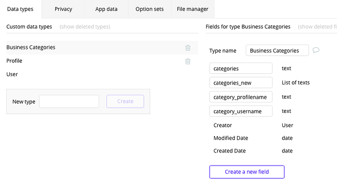

attach the screens that show the Business category - category_profilename in data base. From App Data and Data type
When the user selects business categories (using a multi dropdown list), each category is saved into the business categories thing, and is linked to the Profile thing, and also the User thing.

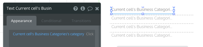

Then when the user wants to review their profile they can see everything they have set up. For the Business Categories, these should present in a simple list, but, as you have seen they are all on one line.

To my knowledge you can’t display it in a list like you want it to be displayed because Bubble see it as one text - because the way your database is structured.
My recommendation:
Use option sets - the multidropdown should refer to the option set. I presume what you have is static choices in the multidropdown.
(edit - made a mistake, my bad)
2. In the Data type Business Categories create a field CATEGORIES and set them as a List of Options Sets.
Set the RG’s to display Business categories as you want
You must use List of Texts if you want to have it displayed it as a list.

attach the screen what the user picks in the multidropdown and how is it saved
I have worked through the editor, setting up the options list, and creating the repeating group, and success!! When the data is displayed it is now on separate lines
