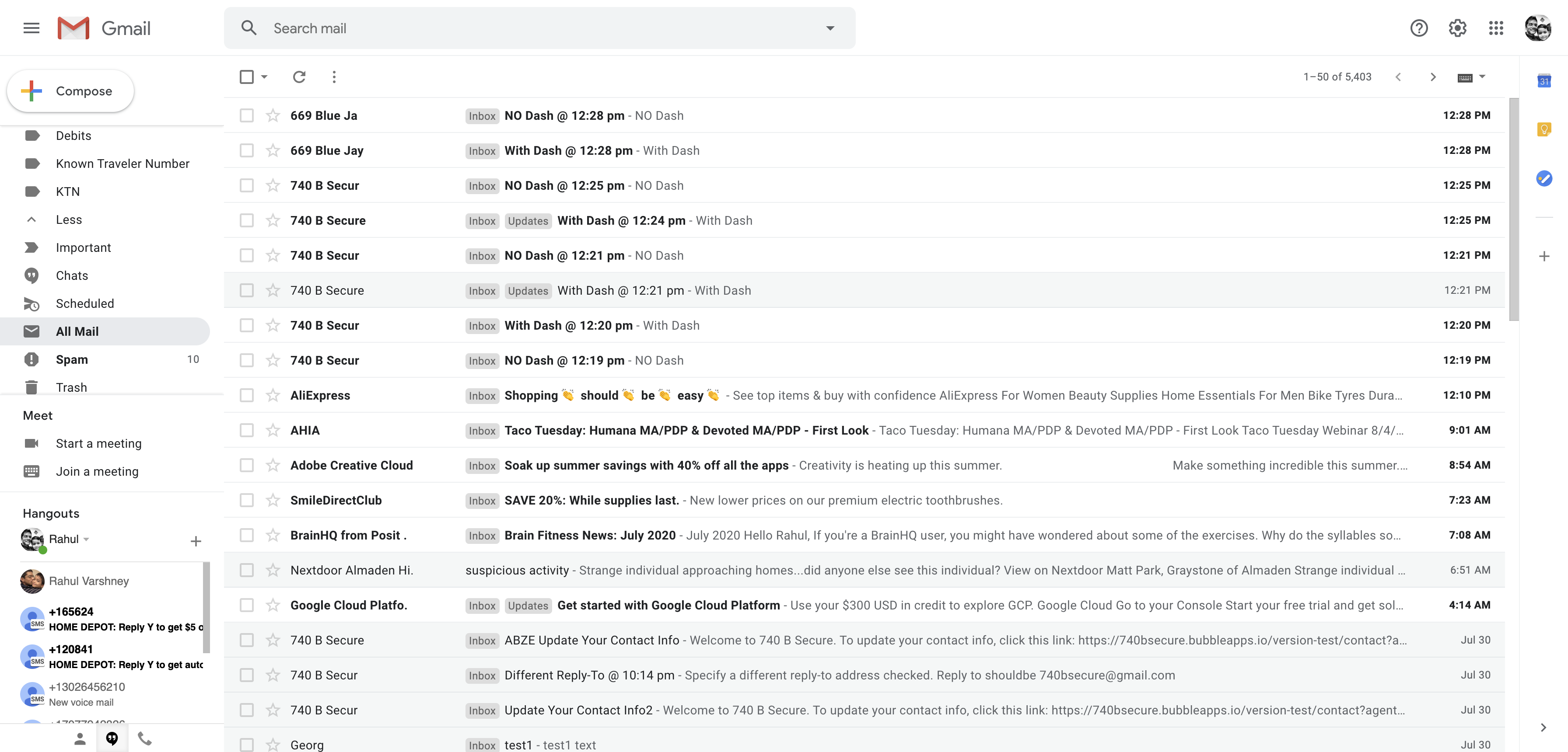

Hi Emmanuel, I think I may have found a bug (as I was figuring out the reply-to feature, I found this thread). I found that I had to add a dash (“-”) between “Name” and the < email > in the Sender Field.
So, for example, if I specify Sender as 669 Blue Jay < 669bluejay@gmail.com> , the sender name gets cut off in Gmail and shows up as “669 Blue Ja”:
But if I specify Sender as 669 Blue Jay - <669bluejay@gmail.com>, the sender name displays correctly as “669 Blue Jay”.
I added the dash on a hunch, fortunately it works. Is this some G-mail formatting issue? I haven’t checked other mail apps. I am using chrome on macOS Catalina Version 10.15.6.
