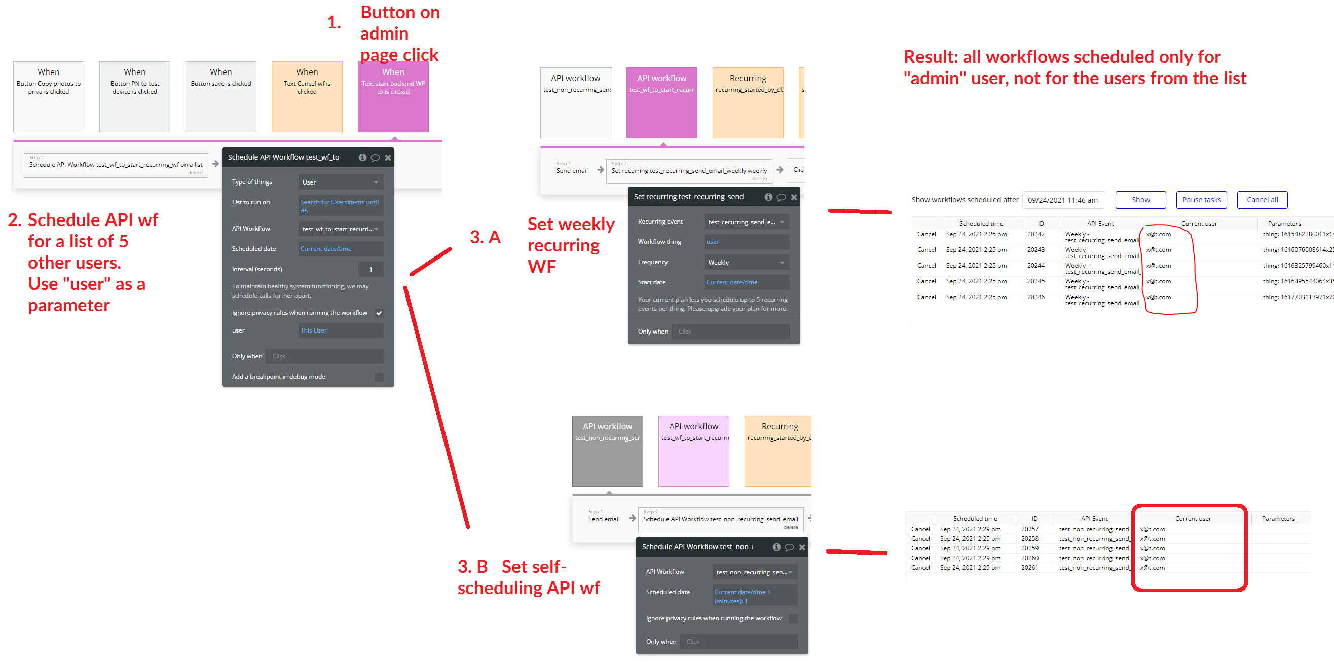

I’ve tried Database trigger event + changing db field by bulk action but it still doesn’t start without opening an app by the user

Hi Anthony, thanks for the advice, but it didn’t work in my case.
I tried it with “self-scheduling workflow” as you proposed and with “Recurring event…” (available at Professional plan and above) but it didn’t schedule workflows for users from my list, only for the current user (who clicked the button on the admin page). Because of that “Current user’s email” also populated at all workflows with only my current email.
UPD: I just changed “Current user’s email” to “Current workflow user’s email” and it uses emails that I need, despite showing that all workflows started by the user who clicked the button. Not sure yet if it may be a problem that workflows scheduled not by user that need that workflow, but from “admin” user

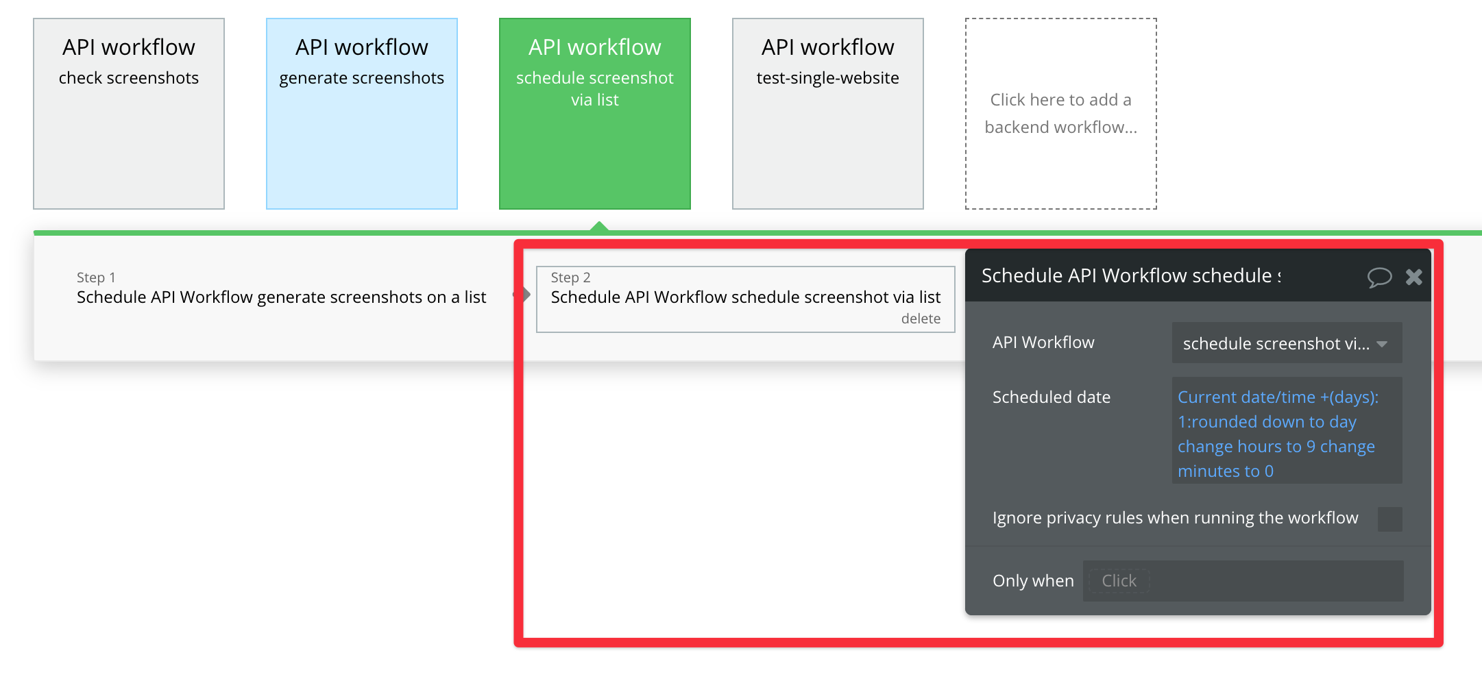

Firstly you don’t need the professional plan to set up a recursive workflow. Just use the normal “Schedule API Workflow” event. Here’s what mine looks like and I have a standard Bubble paid plan.
Secondly, the user email you’re seeing in the logs is just the email of the user that triggered the workflow.
The email that is actually used inside the workflow would be the user’s email and not the admin email.
