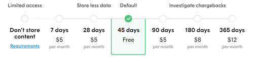

I use PostMark to send those emails, so I can check if the users received and read it thru their log system.
How long does PM retain such logs?
Forever I think.
I will check my logs…
Untill 365 days.
But you can also program PostMark to send a POST to your App if any message bounces (meaning that the emails was not delivered). And you can work with this information as you want.
