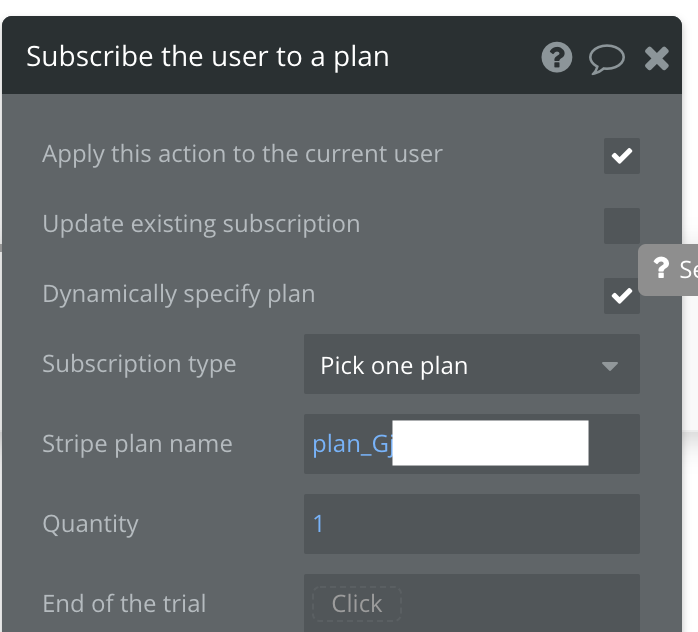

The trick where I got stuck, is actually to check “Dynamically specify a plan”, that’s where you can enter your plan ID!
And it works, no more " Stripe error: No such plan: plan_XXXXXxxxXXXX; a similar object exists in test mode, but a live mode key was used to make this request.

One last step. How do you specific the price??
When Dynamically specify plan is unchecked, I can pick the price ID. When Dynamically specify plan is checked, I can insert the plan ID, but then how do I specify the price?
I did not have this need/use case, but I’m not sure it’s doable. In my understanding the price is linked to a plan, defined in Stripe.
For a different use case, which is presenting the price in various currencies, I created a plan for each currency, and I dynamically display the buttons to subscribe on bubble.
