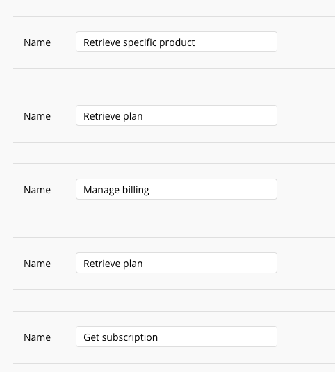

API connector for the following
Bubble stripe plugin for the other stuff
Signup as seller
Subscribe as seller
Charge user

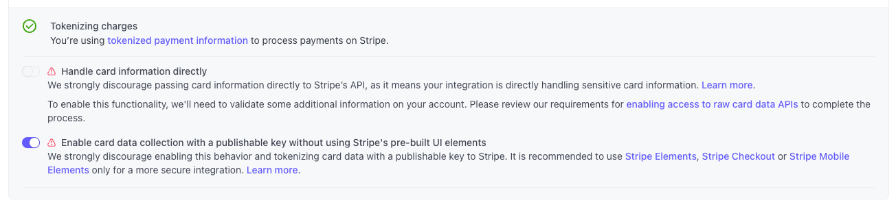

I gave it a shot and got this error
Which went away when I checked this box:
Right now things are working using the version 2 of the plugin but I was wondering if someone knew a better way to make it work using the V3 of the plugin instead.
