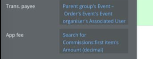

Hi @Oliver-wholegraintech, nice to have your help again! Yes, I have checked that. Here’s a screenshot:
