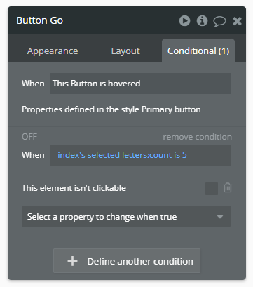

Finally, if you set your submit button to not be clickable by default (which you can do by checking the box on the button’s Appearance tab) and you add this condition to the button (in your case, the count would be 10, of course), you should get the desired result of the button not being clickable until the custom state list contains 10 items, and that will only be able to happen if there are no duplicates selected in the dropdowns.

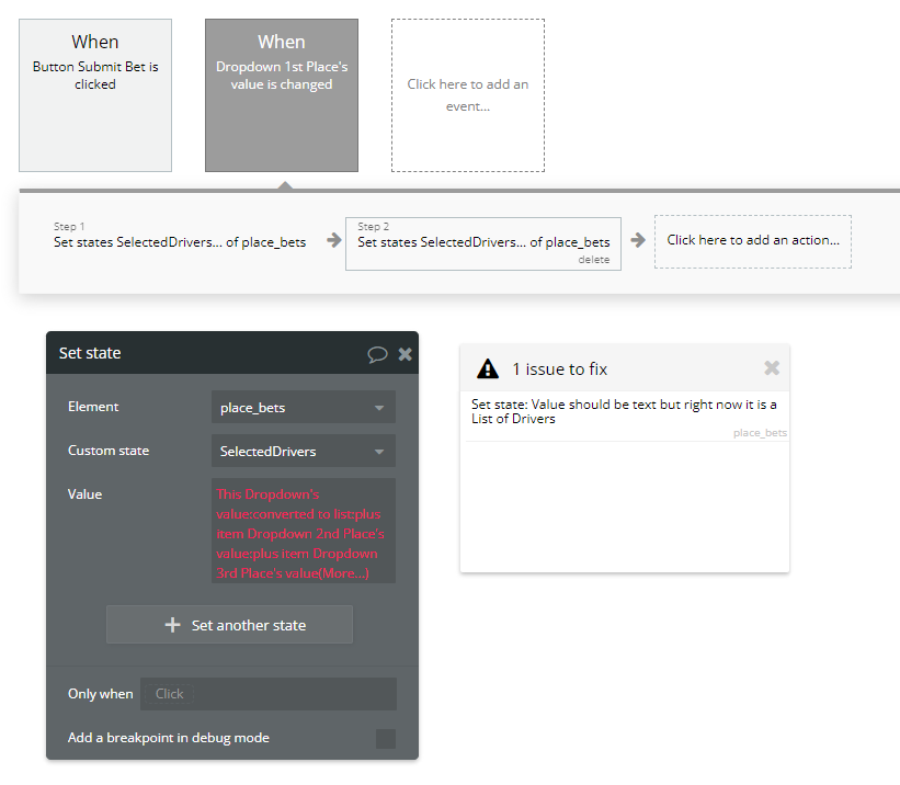

I have also tried it your way, but for some reason, I keep getting an error when filling out the Value area. Not sure what I’m missing here.
I have created the State called SelectDrivers on my page called place_bets.
Does it matter what element i selected to create the State in… I have created it on the page level. My dropdowns are in a group inside another group on this page. Not sure if i was meant to create the State inside one of the groups.
The error message in the first screenshot is telling you what the issue is. Your custom state has the wrong state type… it’s a text, but it needs to be list of drivers.

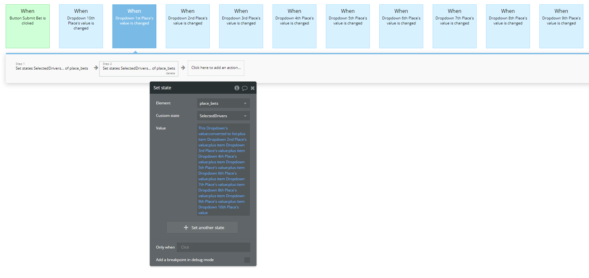

Ok that worked, It removed the error.
But after completing all 10 dropdowns and the submit button, I tested it out by selecting the same name in dropdown 1 as well as in dropdown 2 and choosing all different names for the rest of the dropdowns. Unfortunately, as I hit the submit button it still submitted the duplicate entry.

Hey Mike, yeh it all seems to be correct.
Sorry, i am very new to Bubble so still earning. But adding a text component to the page, what am i adding in as dynamic data?
It would be place_bets SelectedDrivers:each item's whatever.
Ok so now when i make my ten selections and i make sure I selected a duplicate, the text box now shows up all names i selected except for one of the duplicates. So in the text box, it’s now showing 9 names.
But when i hit submit it still saves the data with the duplicate selection.
The button shouldn’t be clickable when there are only 9 names in the list. If you want to send me a link (via DM) to your editor, I can poke around under the hood.
