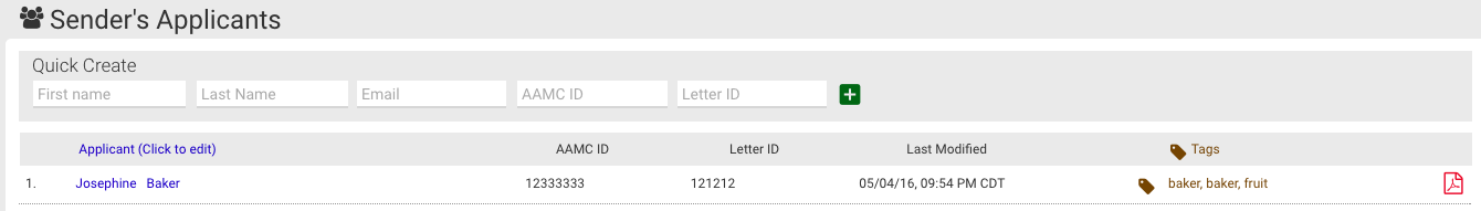

I started composing a reply asking for any progress on this and as I was typing it came to me…
To solve this issue, we did the following:
Create the repeating group and customize the first group with the text, images, buttons, etc…
Once you have completed the design, then copy and paste the entire repeating group - we renamed the new one RG Header
Change the number of rows in RG Header to 1 and adjust the height to the desired height of your header.
Move this RG Header to directly above our original group
Bold all the text fields in RG Header
Add a row to the table through Data / App Data that contains the values you’d like to use in your header. After adding this information, get the uniqueid for it.
Change the data source on RG Header to be exactly the same “Search for …” except add criteria to match the uniqueid with the uniqueid you for the row you added
This should solve your problem.
A couple of side notes:
You may need to exclude this header row from the rest of your “Search for…” data otherwise it will show up. For us, this didn’t matter because we show data relevant to each user and this header row we created was assigned to no users.
I tried to get the header to show just by showing “text” instead of “Search for…” data but then the repeating group would have no rows of data and just collapse. Not ideal because then your header disappears. If someone can resolve this, then we can save a data retrieval call.
