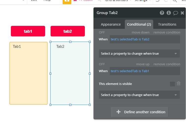

Ok thank you that is a massive step forward. I have set up the condition as such;
Ok, next is to make the buttons work. I go to the first button ‘tab1’ and set a workflow. It says When test's selectedTab is Tab1 and I make it viewable. This works and displays the orange Tab1 box on button click.
But, I can’t get the box to disappear again!? Have a look at the blue box (Tab2) conditional. You can see that when Tab1 is selected, the blue box should disappear - but it doesn’t?

On the Appearance tab for both of the group elements, uncheck This element is visible on page load. Then, construct a single condition as you have, with the element being visible when the custom state is set to a particular value (by the way, in your second screenshot, you haven’t added the This element is visible option to the first condition). Finally, add workflows to the buttons to set the custom state to a particular value when each button is clicked, and you should be good to go.
Also, as @chris.williamson1996 mentioned, custom states are case sensitive. I see in your first screenshot in your initial post that the default value of the custom state is “tab1” with a lowercase t. However, in your conditions, you are using an uppercase t. Pay attention to those kinds of details because they can definitely trip you up.

I have corrected everything you suggested. The buttons do make the groups visible on click, but the groups won’t disappear when I click the other button. This may be because the Workflow for the button simply “Show’s” the group, whereas equibodyapp suggested below that the workflow needs to set the custom state. I tried this but (as per my original message, the customer state then is not available). See below for my screenshots.
I can’t assign my custom state because it is not available? I could create a new custom state, but then why did I create the first one called selectedTab .?
