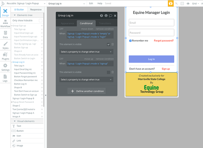

Okay - so clearly the Signup/Login Popup has a custom state of “mode” related to it.
But how do I find out how this state is set initially? Seems to be empty by default - then changed in workflows.
Where is the custom state defined?
How can I see - or add - additional custom states for this instance of a reusable element?
Sorry - I dug through documentation — but it’s not clear to me — still a Newbie.
Is there a lesson related to this?

Gaby! Thanks… that’s where the info was hidden.
I saw the state being set in conditionals, I see how to create a new state - but could not find existing custom states.
Is there any way to set the start condition for a custom state?
The login/popup was testing for mode= “signup” – or “login” or “empty”, I can see where specific buttons SET the mode to both “signup” and “login” — but I found NO setting for “empty” – and to me it looks like mode=“empty” is a string, but not an EMPTY string… ie. blank.
Charlie
Did you find an action that sets the value to the word “empty” ? Generally, if it’s going to mean empty/no value, then you just leave it blank.
Either way, you can set the state upon page load so that it starts out with whatever value you want. When page is loaded > set state.
Thanks… I always forget the page properties box has no workflow - I have to select workflow from the side menu. Thanks,.
