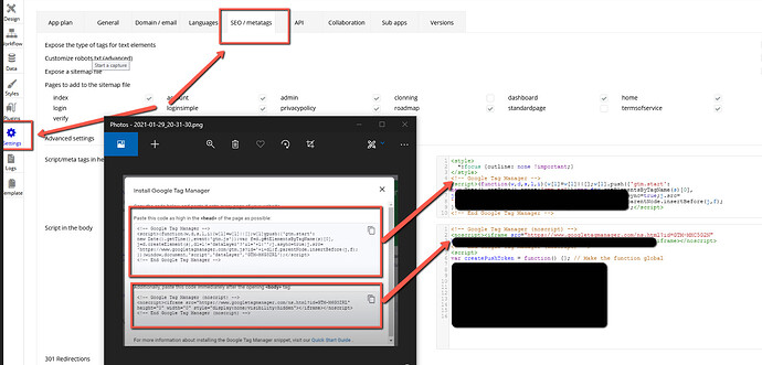

#3 Insert GTM (Google Tag Manager) script into your app. Same video. Not need any plugins, very simple to do. Just copy paste two times:

Hey this is great. Just a quick question though. How did you actually connect the FB pixel to your page? Did you put the code in the same place as the GTM in your pic under SEO/metatags in the header?

Not need to put Pixel base code to the page. You have to put GTM code to the header and body.
GTM will run your pixel script.

As the name suggests, Tag Manager, it ‘manages’ all your tags: Analytics, Pixel, Google ads and so on… You just add any service as a tag to your tag manager, and it run it for you on your site. No plugin needed, just insert GTM script into header and body.
