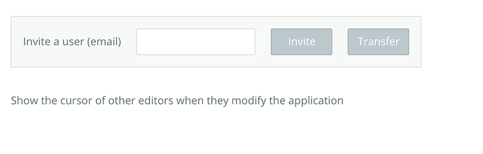

I have an app (free plan) running on Bubble’s engine V3 that doesn’t have the option to be transferred. What could be the reason?
My other apps (also on free plans) on V3 can be transferred without problems :
I think I found out why. The app I can’t transfer is built on a (free) template :confused:
I can understand the restriction if it’s based on the template. But if the template price = $0, then you should still have the ability to transfer it. (Though I believe that may still copy the underlying template association, leaving you in the same situation).
Seems like it’d be worth following up with Bubble Support.
I think I read somewhere that you can transfer an app that is based on a paid template and that transfers ownership of the paid template too. Anyway, I ended up copying each group and recreating the workflows in a blank app and that did it. Wasn’t long as it was just a one-pager. But not sure to understand the purpose of that limitation regarding free template…

Having some trouble transferring a site I built for a friend to him. When I enter his email in the Invite a user (email) field on the Collaborators route in setting, the invite/transfer app button are not clickable. Any ideas what could be the issue?
Demo of issue: https://www.useloom.com/share/66cf21611ce248d880552c0b3b021957
In order to transfer, there has to be a Bubble account associated with that email address. So, if your friend hasn’t set up an account, that could be a reason why.
Also, a minor thing (hard to tell from the video). It looks like you may have a space following the email address?
If that doesn’t resolve, let me know and I’ll take a closer look.
Man, you were right @dan1. When I pasted the email address an extra space was being added. Good spot and thank you!
Glad that worked. :slight_smile:
