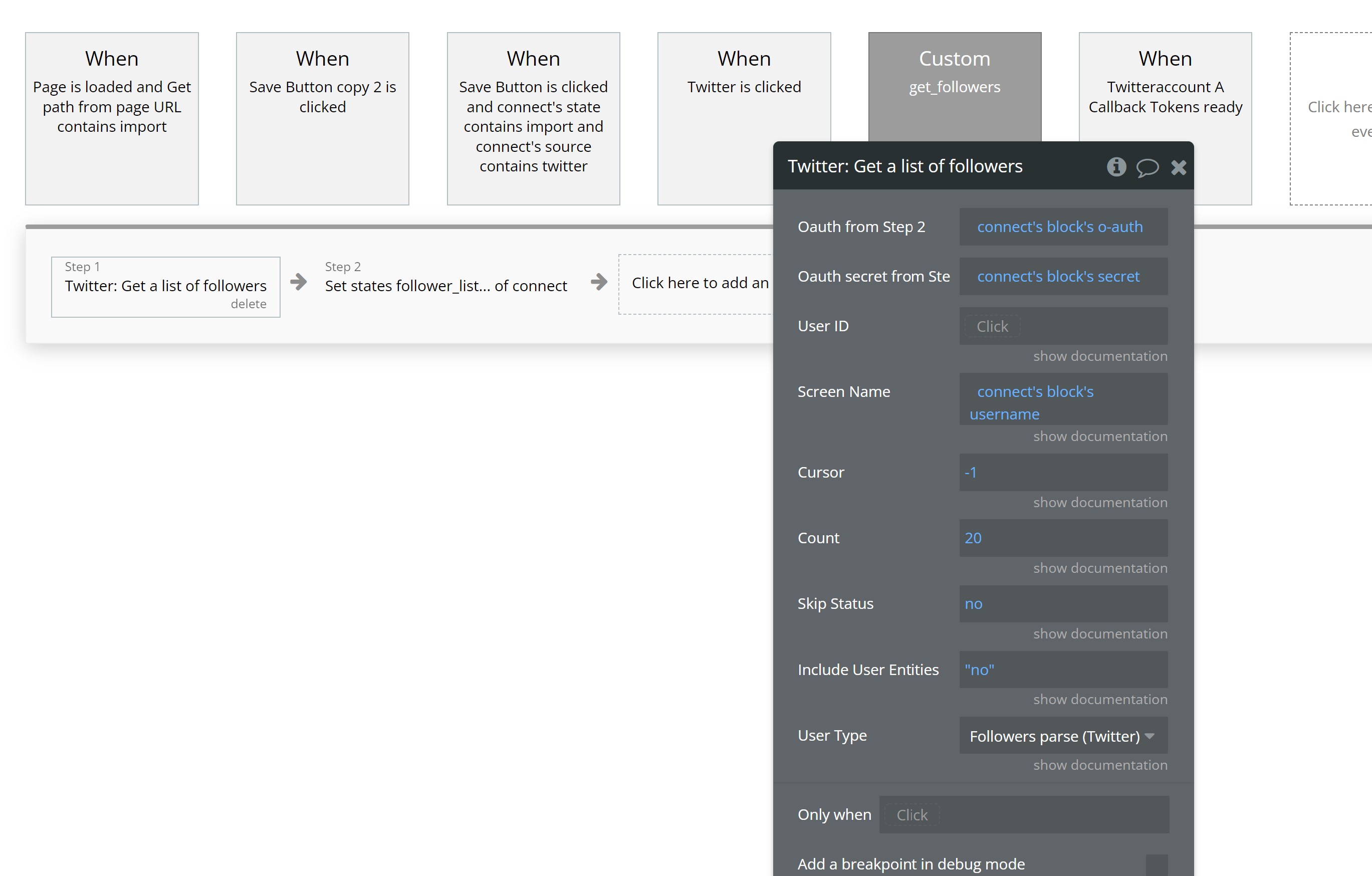

Not able to pull followers, getting error in my app and demo - any plans on updating this ? @ZeroqodeSupport @levon ? Thanks!

@levon @ZeroqodeSupport Still getting an issue. All of the configurations are some just as in the demo editor. I’m able to authenticate users but not pull in their data or interact with their account. Getting an undefined error (all of the URLs ARE correct). I triple checked the docs and URLS, maybe the version in the demo is different?
Hi @PasqualeJS
Can you please show us your setup of the plugin, particularly the screenshots of the workflows on how you are displaying the information on the page(get details button workflow or a custom state). Also, please have a look at the screenshot of this action, you might be missing it in your setup.
Looking forward to your reply.
Regards,
Zeroqode Support Team
@ZeroqodeSupport Sure- I’m saving the auth as block set as the page state and user. The data is being passed correctly - still running into an issue. Maybe its the refresh token? As always, thanks for the help.
Thanks for the screenshots @PasqualeJS
Due to the fact that we have some additional questions regarding your settings, can you please add our Support Team email to the list of collaborators to your application and provide me a link to your application? This will allow us to check your settings and run some tests to fix the mentioned problem.
