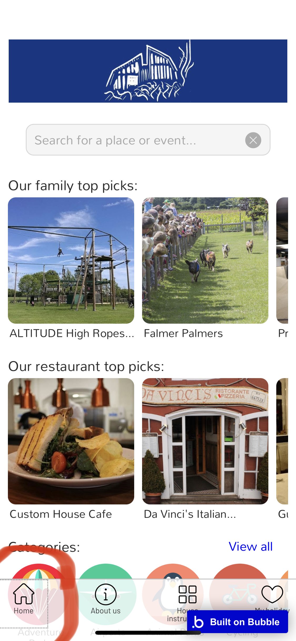

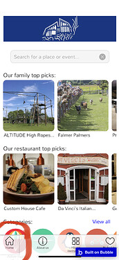

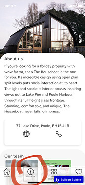

In my menu bar I have some icons within groups to enable them to keep their locations. Although all of the borders are set to none, whenever I switch to another app and then switch back again, the tab that is currently selected shows a border around it.
How can I stop this happening as it looks a bit rubbish from a UI perspective?

You have to add this snippet of CSS to your page.
outline:none !important;
To add the CSS, you can use a plugin such as CSS tools.

Thanks for the response. I have never used CSS before so apologies for my thickness! I have added the CSS Tools plugin and added your suggested CSS to an action as part of my page load Workflow but this doesn’t seem to do anything. I am sure I am missing a step somewhere?

Remove the <script> stuff, and add <style> </style> around the CSS.
So it should look like
<style>
</style>
That should work, if not try the CSS tools plugin by Zeroqode without the style tags, as I’m not familiar with the plugin you have.
@cmarchan Even if the element is styled with borders, this problem will still happen. I do agree though, some kind of styling on the selected element would be useful.
I should note that outline and borders are not the same thing. With this CSS applied, you can still use borders on your elements.

That’s perfect Tim. The CSS now works so that’s great.
