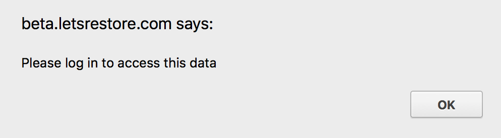

So the odd thing is I get with the Event 1, which should validate:
Here is a screenshot of the workflow and logic.
The dev site is behind a username/password, but this hasn’t been an error if I just default the user to .Eligible = Yes.
Do you have privacy roles set up for the Debt DB data type (or any other data type involved in the workflow)? Under Data > Privacy
There is! I’m not sure how it got there. I don’t remember setting this up nor defining the granular permissioning. Could a workflow or something else have created this?
Is there any harm in deleting it?
