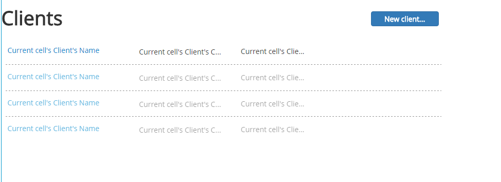

Repeating group in the designer

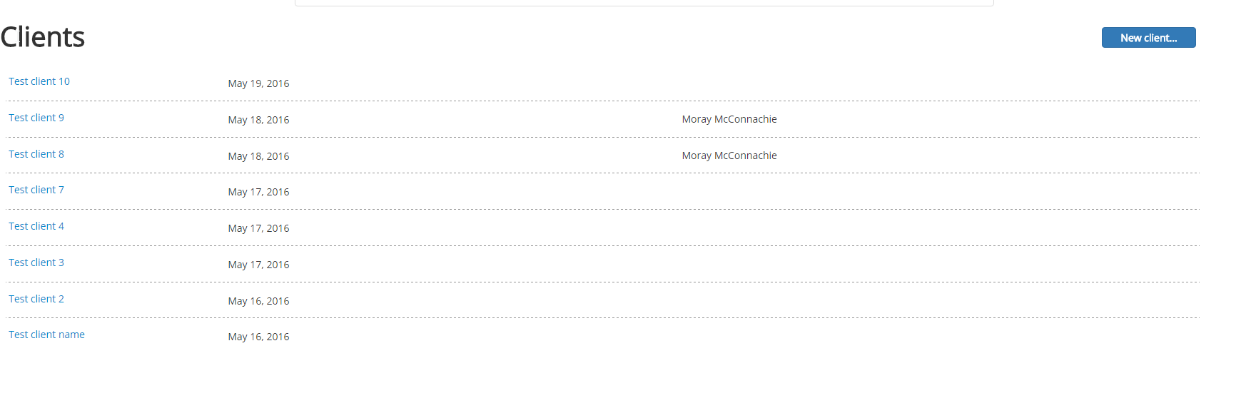

Repeating group in the browser
It looks as though the third field is being set by its proportion to the overall positioning in the width of the container.
Is there some way to have fixed widths in this sort of table setup? Ideally fixed minimum widths anyhow.

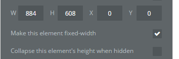

So apparently what you can do is set the whole group to be fixed width.
But that doesn’t seem to help the Breadcrumbs.
Unless you make that group fixed width too.

So it does look like you can put elements into a group, and make the group fixed width.
