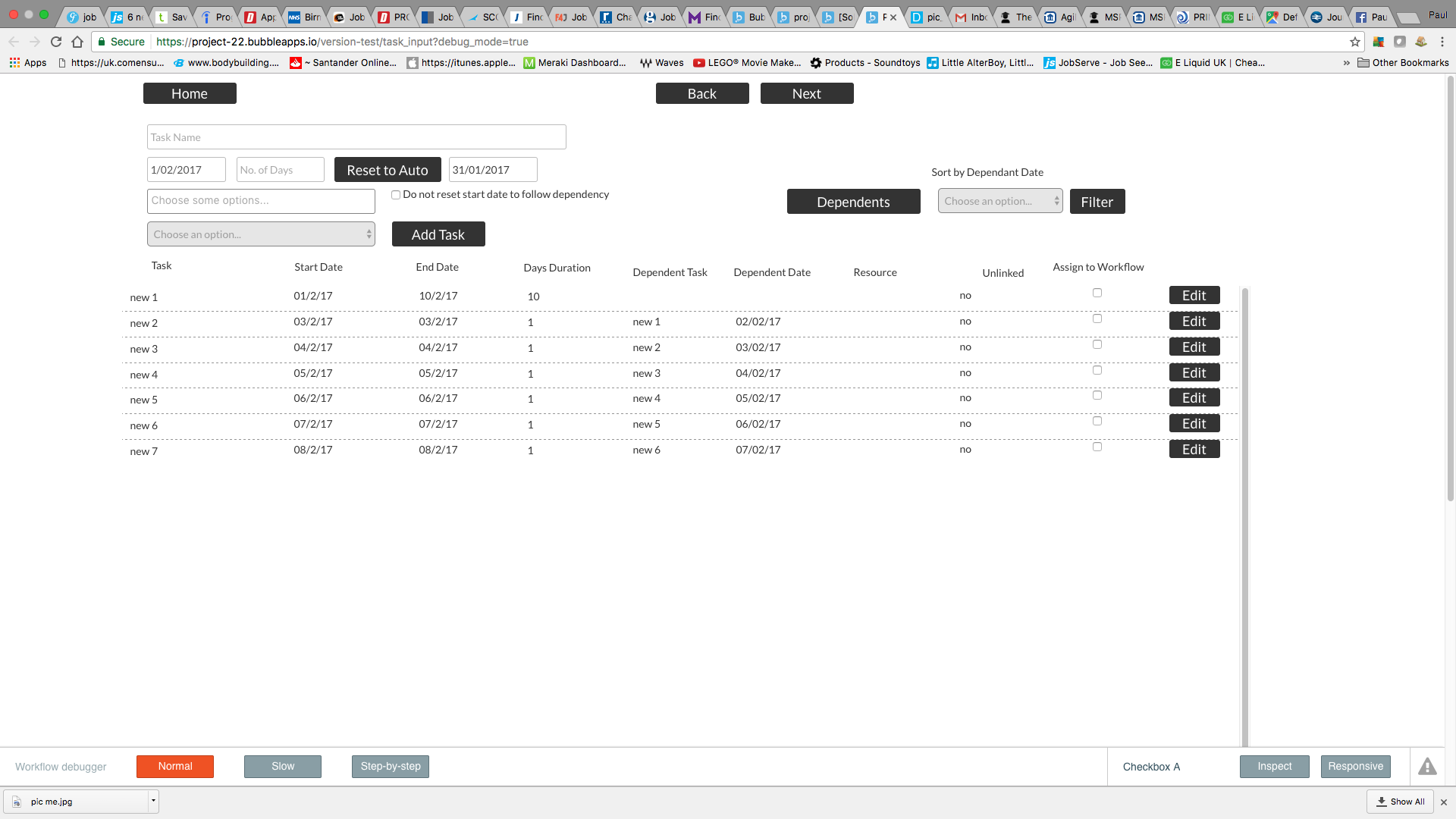

This is achieved by saying the task when added, if it has a dependency, to use that dependendies end date +1 as the start date to the new task. So far so good.
If I go in and change the date for “New 1” however to 10 days it updates that task, but now all of the other tasks, which are dependent on that on and each other are “wrong” in that they are not following that date:

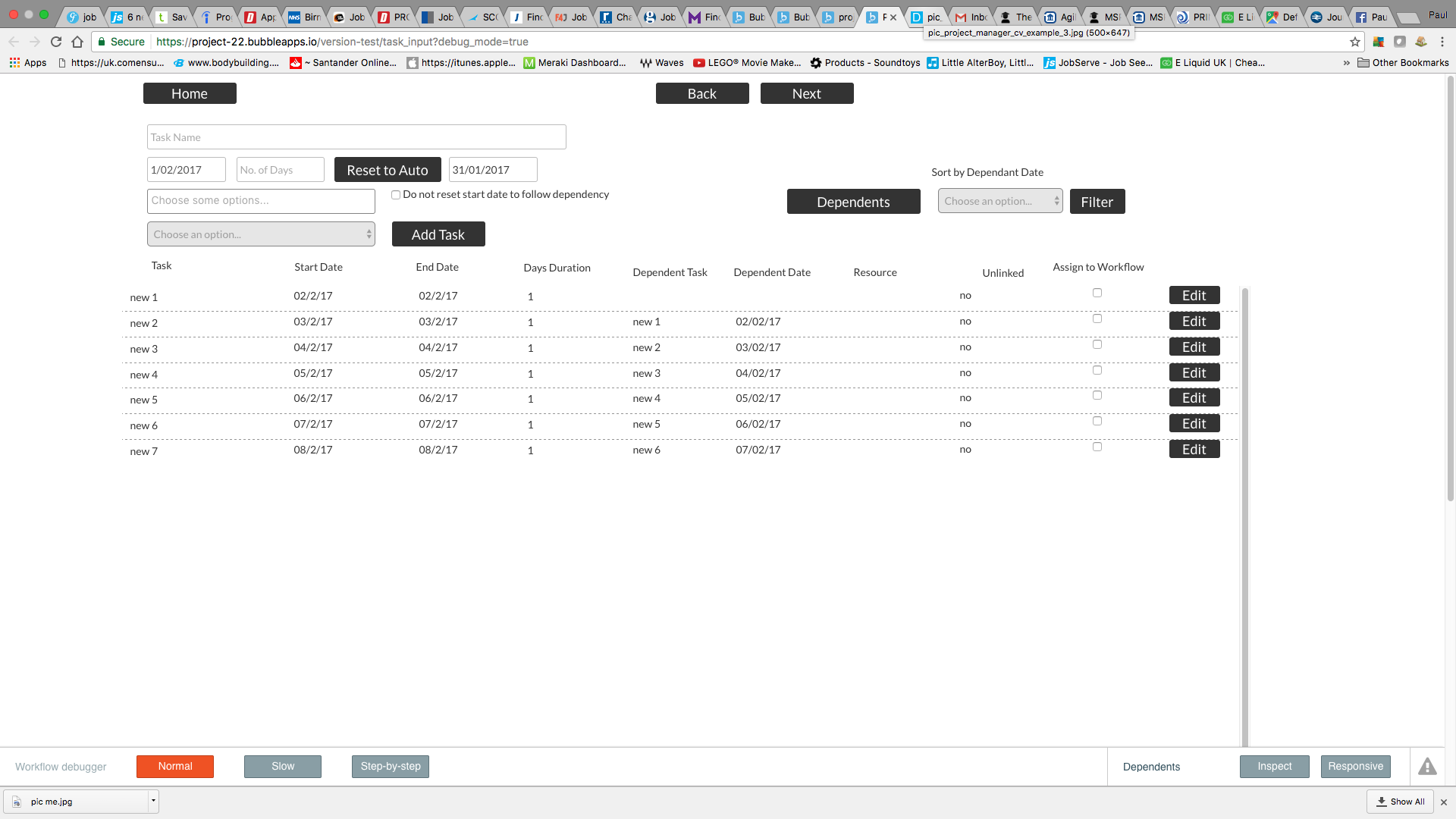

I have tried every which way to build my “dependents” button so when I click on it, the logic parses each task in the repeating group and checks the dependent task it has, and updates itself accordingly to the new date - so in this instance “New 2” which is dependent on “New 1” would change the start date to 11/2/7, then “New 3” would update itself to follow “New 2”'s end date+1 and so on, until the group has been updated:
I achieved what is shown in the screenshot above by going in to each task individually and updating each task, then it works. How can I get the “dependents” button to update each task in the repeating group by just clicking it once?
I have every way I can think of but I am starting to think it just cannot be done in Bubble.
