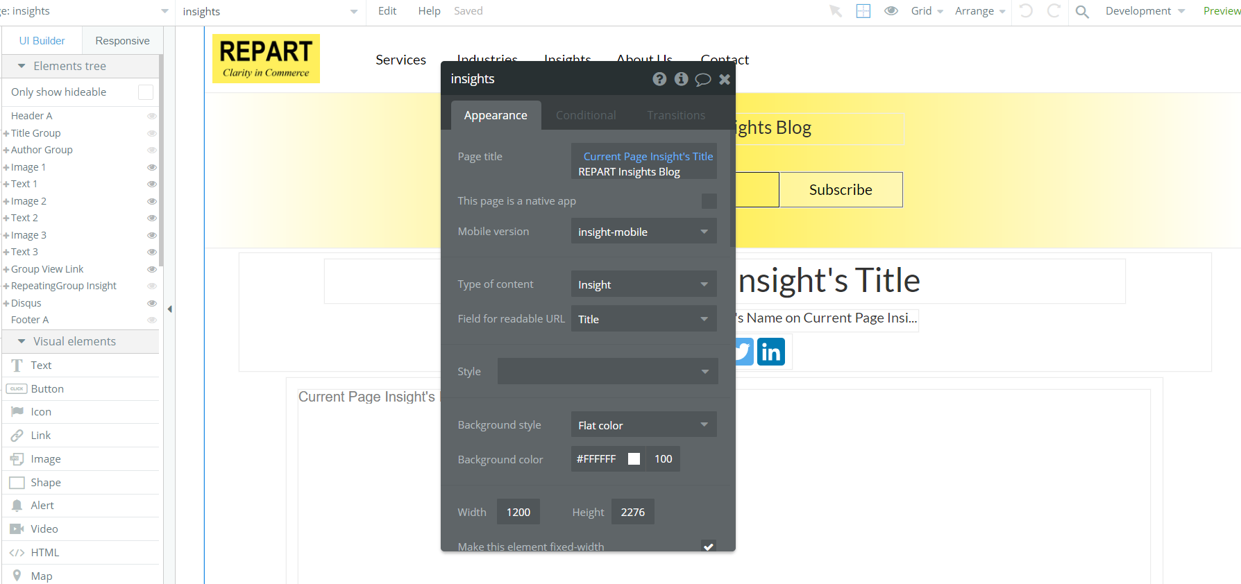

What I did (with some tweaking) for my site is to create a main blog page called insights, with the type of page being insights (the data type). I then used conditions to hide and show content based on the data that is sent to the page. If the page comes up empty (ie repartconsulting.com/insights/), meaning no data found, then the blog posts content area is hidden, replaced by list of blog posts, a subscribe button, and titles, etc. It gives the feeling of some URL structure that you would find on a normal blog.
Take a look here: https://repartconsulting.com/insights
