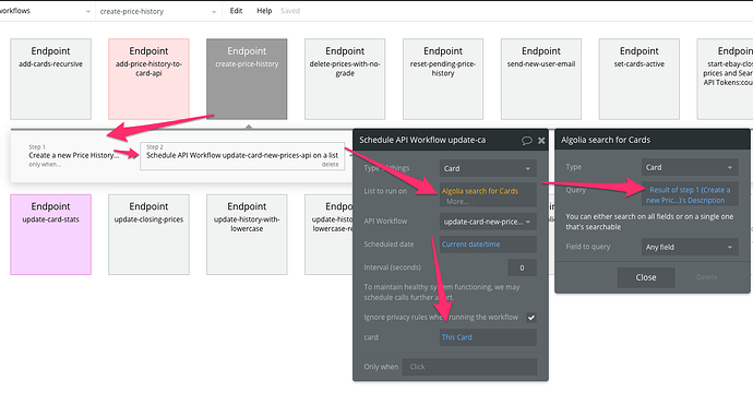

Hi, I am attempting to use Algolia as a data source in a backend workflow action but every time that action gets called I get the following error:
“Workflow error - Sorry, we ran into a temporary bug and can’t complete your request. We’ll fix it as soon as we can; please try again in a bit!”
Step 2 in the below workflow always fails with this error.

@juancamilovasquezard I did take another look at my workflow and I removed the workflow based on a list and created this to be fully recursive with no Schedule Workflow on List actions. I believe this is what you were saying and I agree you are correct here. Unfortunately, I still get an error when this workflow initiates. You can see the update process below.
Hi @rivergalli,
I saw in the server logs that the step 1 “Create a new Price History” failed.
And your’re trying to use it as the data source when you schedule the api workflow
Maybe there can be an issue?
Regards
Juan
@juancamilovasquezard That is is just a conditioning failure. As in, it did not meet the condition to complete that create a price history item. This process checks for dupes first.
Yes, I am starting to think this is simply a bug in the Bubble/Algolia interaction that prevents using the Algolia search as a data source in a scheduled workflow. I recently logged this with Bubble Support to see if they can provide some clarity.
Thank you for all of your help.

@juancamilovasquezard BTW. I just got a response from support and they confirmed and replicated this as a bit. Specifically, using Algolia in a backend workflow. Thanks for the assistance.
@juancamilovasquezard @lucas.ar And for anyone else on this thread.
It looks like Bubble fixed the issue today. I will be testing this later and will confirm. Here is a portion of the response. I am impressed with the turn around time.
"It turns out that there was a flaw in our workflow logic that prevented Algolia data sources from being available on the server when some workflows would execute, such as yours. We have just pushed a fix which should allow you to make server-side workflows that use Algolia searches work properly. "
I can confirm that this does work now. You can use Algolia as a data source in backend workflows. Extremely useful.
