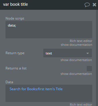

@Kfawcett yes, here’s an example, although there’d be a lot of ways of doing this …
Its setup on a page workflow for ease of testing, it does work on API workflow as well.
editor: toolbox-example | Bubble Editor
run it : https://toolbox-example.bubbleapps.io/version-test/serverscript?debug_mode=true
Button “text variables” …
Properties of some of the steps ...

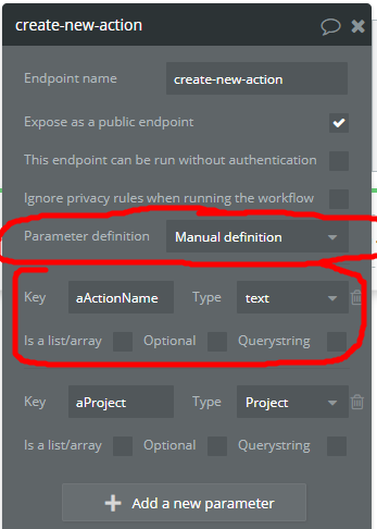

API Workflows implement parameters fairly well:
The big problem with API workflows is that they run on the server with no return signal to the client (the calling workflow). And API workflows, as discussed above, don’t even support local variables (custom states), so their calculating ability is severely limited.
