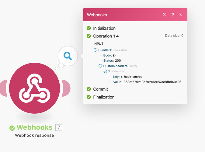

How do I direct it to a custom header. I use Integromat and this is done easily.

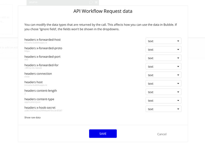

This is my detected data

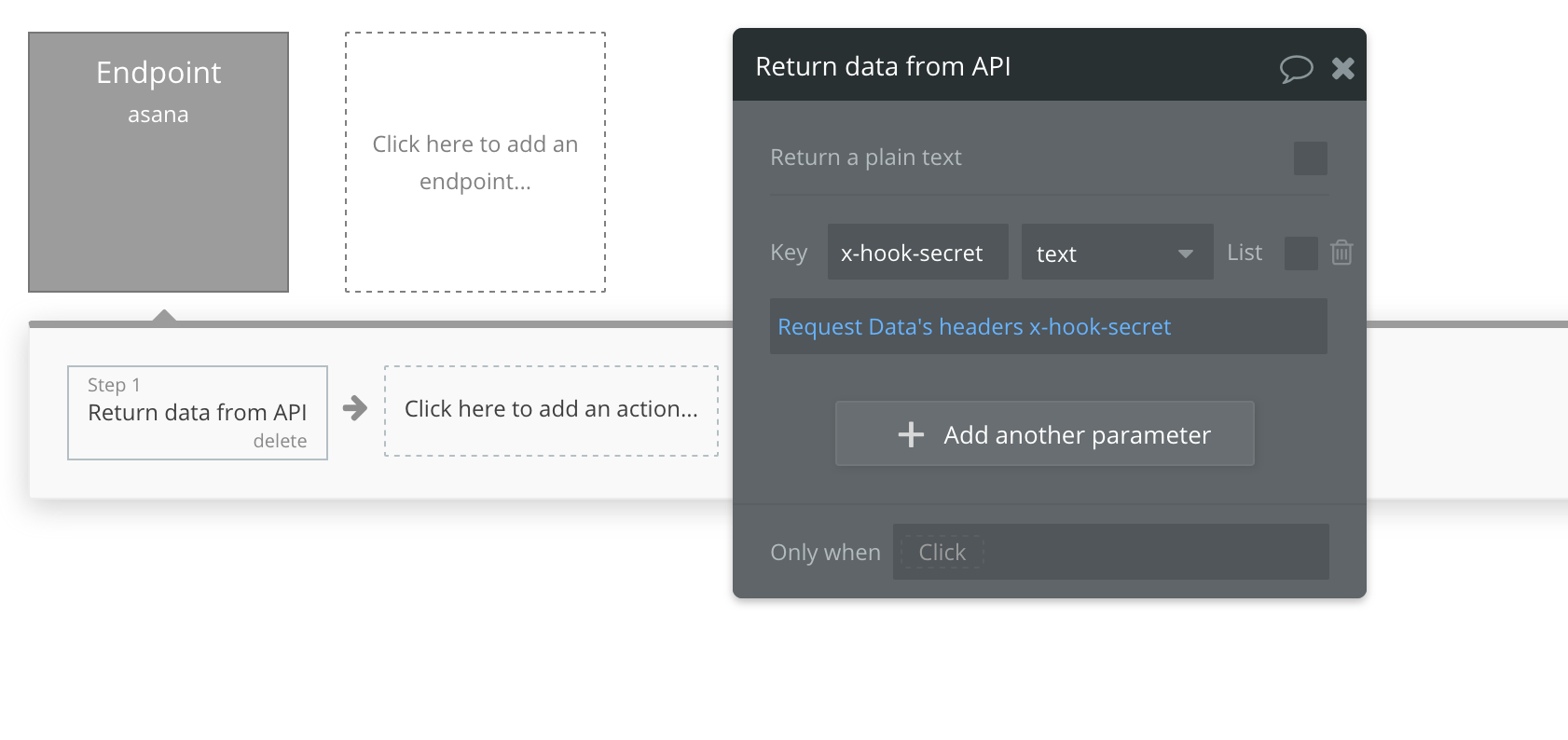

Now how do I respond with the header. Here is where I think Im doing something wrong :thinking:

So I think the data does go through but somethings wrong with my return data to api settings. I need to respond with the data in the header not the body. How to do that?

@amdmakki Is problem you are having about API workflow not allowing you to set header values on the response to Asana?
You have two options as I see it:
  • Request Bubble to add the functionality to set headers on the response. I suggest using a bug report to request it, link is on the Bubble home page > Community.
  • Use an intermediary server to receive the webhook, post it to the Bubble app endpoint, wait for the response, then add the header to Bubble’s response and respond to Asana.
    A disadvantage of this is having to use the intermediary for all the webhooks, not just the initial handshaking.
It looks like you have already started trying this with webtask, if you send me a PM I can give some direction.
