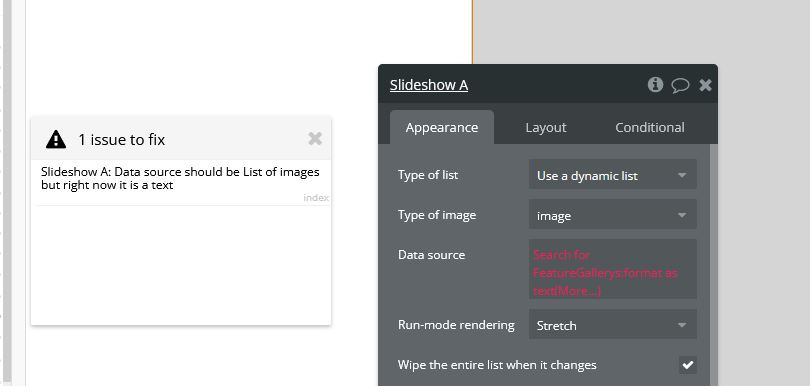

However, I cannot happen the string to a data source field in a Slideshow element (screenshot attached).
Do you know how to solve the issue here?
Thank you
use image for type of data and an array of text as data source (the urls of the images).
If you have the images in a search use format as text to create a list of text with the data you need and the added query string.

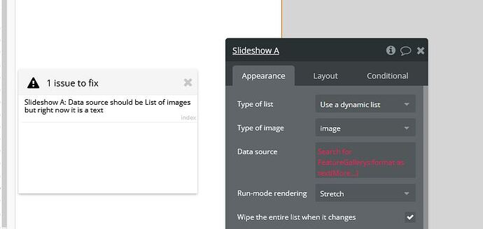

I either get a text type at the end of the data source, or I can manage to get an images. In both cases there is something missing.
Am I doing it right?
You have a featuregallery as the type of image. Change that to image and the error should go away.
I still have the same problem unfortunately, bubble sees at a text.
If I add used as an image at the end of the data source string, I get an image, not a list.
I’ve also tried in the “format as a text” to convert the content as a list.
in format as text add a special character in the delimiter option, something like | (chose a character that is not in the text), then add split by with the same character used as delimiter.
If from your search you already get a list of pictures, instead of the format as you can use each item find and replace with regex expression enabled. Set $ as the pattern to search and add ?ignore_imgix=true as the text to replace.
