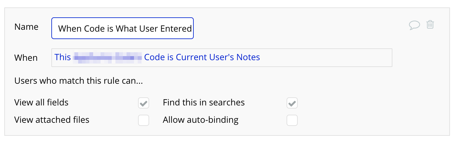

Strange, i tried what was suggested with some tweaks, but it doesn’t work.
Basically I set user’s entered code into a field called Notes.
Then I search the data type for the code that was entered.
Nothing was found.
The privacy rule is: when the data type’s Code matches the user’s Notes.
It only works when I set the privacy rule back to publicly visible.
Any idea?

I’d persevere and double check everything - I use the same technique and it works.
  • different to me I don’t set the code - I set the ID of the matched thing - so my rule is does ID = ID of Thing. But shouldn’t matter.
  • Are you sure your are setting the code? Is the code matching case sensitive? (Obvious stuff I know but worth double-checking before looking for more difficult answers)
I’d suggest you make the simplest possible prototype in isolation of your main app to prove that it works (or not). (I bet you it works )
Thanks for that - appreciate it very much! Will recheck everything and try again.
