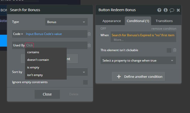

Try flipping the expired and first item. So it would be Search for bonuses : first item expired is no

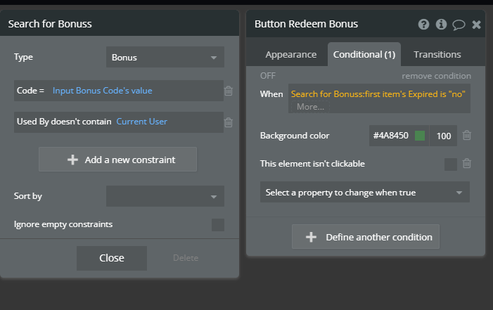

No go. I’ve got it setup so that the button is only clickable once it finds a valid bonus code but this search makes the button immediately clickable and doesn’t change when testing different codes. Here’s how the search looks:

The condition is when the expired is no and the used by current user is no

Have you got ‘this button isn’t clickable’ ticked on the appearance tab?
Yes i do. I don’t want it to be clickable until it searches and finds the right bonus code

Privacy rules are public so no issue there. Ive tested it and it now accepts any code and even expired ones so the conditional suggested above is not correct.
You could try a different conditional
Add expired = no as a constraint on the search.
Then instead of :first item what you actually want to do is check that there is a code in the database that matches ALL those things. So use :count >0
Basically saying, when you find a code where the value matches the input, and doesn’t contain user and is not expired then you can click it.
It should then not return the same count next time as the count should be 0 because the user is now in the contains field.
