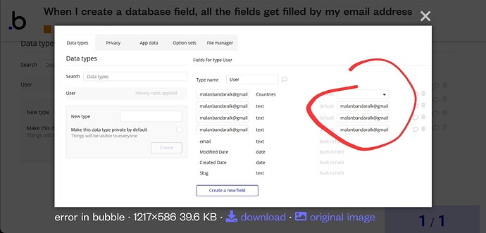

When I create a database field, all the fields get filled by my email address
I am unsure if this is a bug, but when I try to create a database field, my fields get filled with my email. This is the second time I have had this issue. The first time I logged out, I removed all my browser data and deleted the entire project to ensure no problems like this. Now it’s happening again,

Hi there,
It looks like you have a default value set; you can leave this blank:
As @msgiblin pointed it out correctly, I only add that the naming is also very confusing on your file, do correct it.
Thank you! You are amazing for sharing. I now realize the problem is due to the auto-fill feature on Edge. I send a feedback message to the edge team as a bug so they can look at it.
