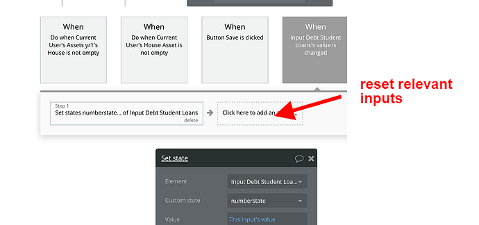

Hello!
Thank you so much for the reply.
I tried what you did and it didn’t work for me.
Did I miss something?
This is my first time using custom states so not sure what to do
I added that and still no luck…
It still shows the negative number…
Could it be missing something else?
Really appreciate the help. Thanks!

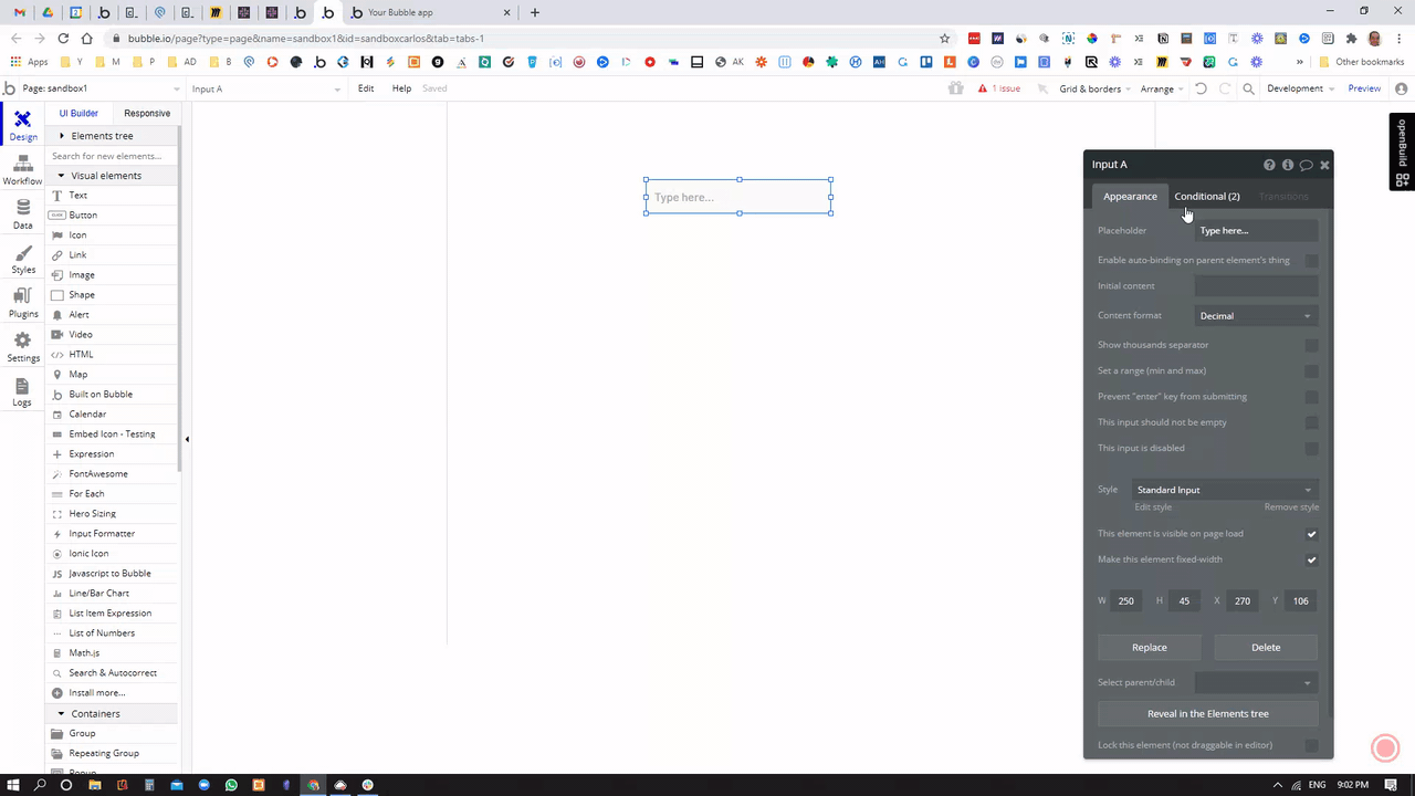

It does work. Please see this GIF:
Yes, so that works because you are inputting it in the moment.
In my example the user answers questions and it saves it on the database as negative.
What you are showing me there is a live input of a negative number that becomes 0. But in mine since it’s already negative there is no change and so it doesn’t become zero…
Mmmh … my understanding was wrong. Very sorry for that.

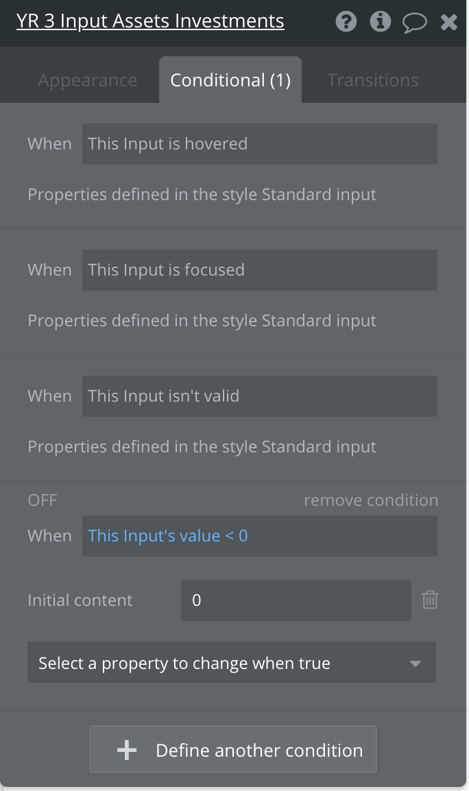

In the flow that makes the calculation … restrict it from sending negative values.
Best of luck with your app
Great that is exactly what I want to do! Where do I input that restriction? Sorry, still learning!
All events and actions have this area to apply conditions:
OH I got it now! I was just applying the conditions to the wrong place. Did it on the workflow saying if it is bellow 0 then show 0 and it worked perfectly.
