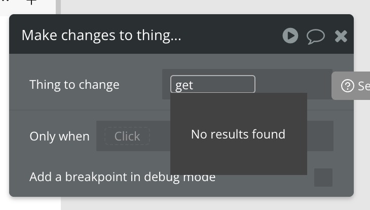

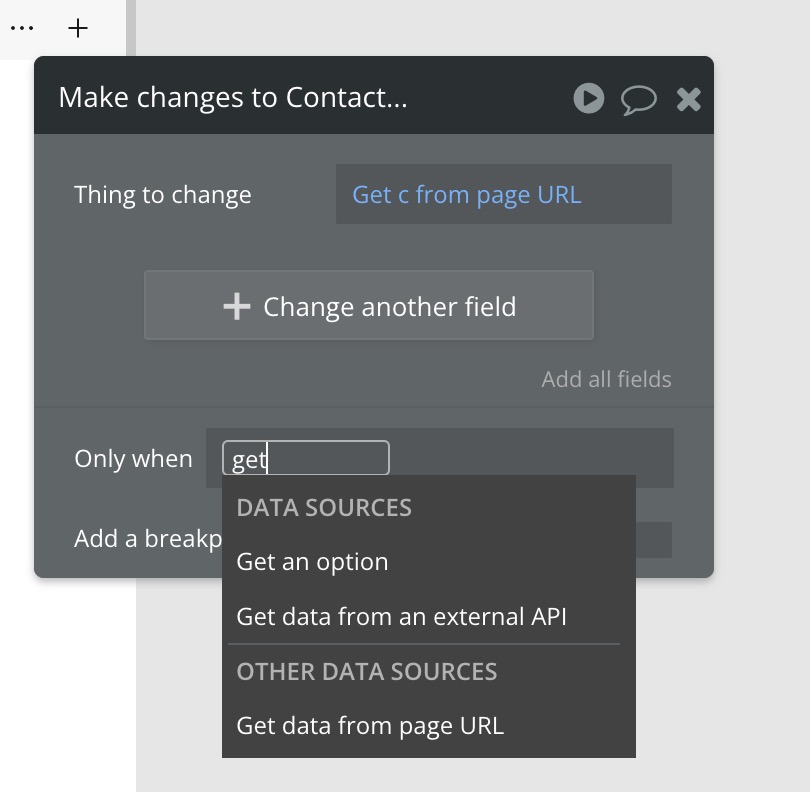

Every time I want to make change to a thing like this:
I have to type it here:
Because here it’s not available:
I’ve been using this workaround for month and finally decided to write a little post about it
Have a good day people

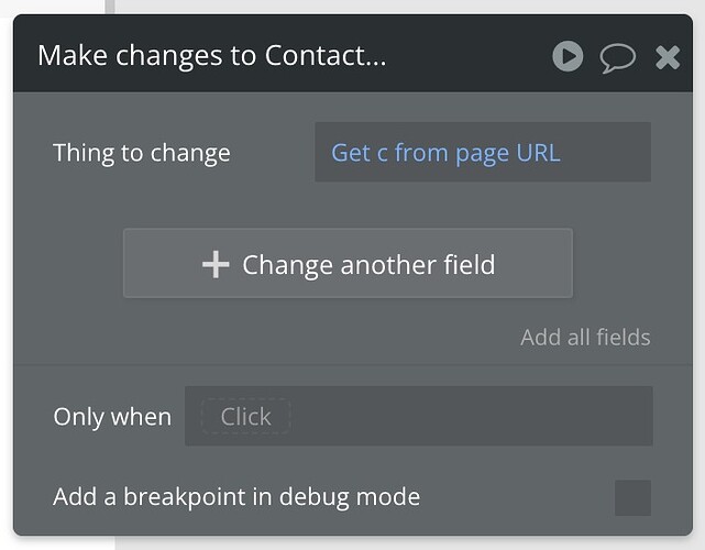

The case here is because the result of the expression “Get c from page URL” is a text.
The expression is available in the conditional field because you can make a conditional expression based on a text.
The expression is not available in the make changes to a thing field because the text obtained from the expression is not a thing in the database.
What you can do in this field is to perform a “do a search for”, using the text obtained from “Get c from page URL” as a filter. This way, you are actually making a change to a database record.
If the c in the url is a unique id of a thing, this can be set as a thing type and you don’t need to do a search for. The url parameters can be a thing (a lot of type) not just a text.
