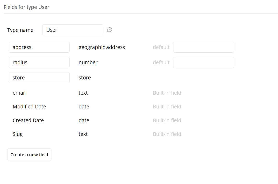

I believe you are looking to do the below
I do not think you need to do any advanced filters or merged searches. I think all you want is to use the stored ‘radius’ numerical value and the stored ‘address’ value to find locations that are within the radius and address of the user.

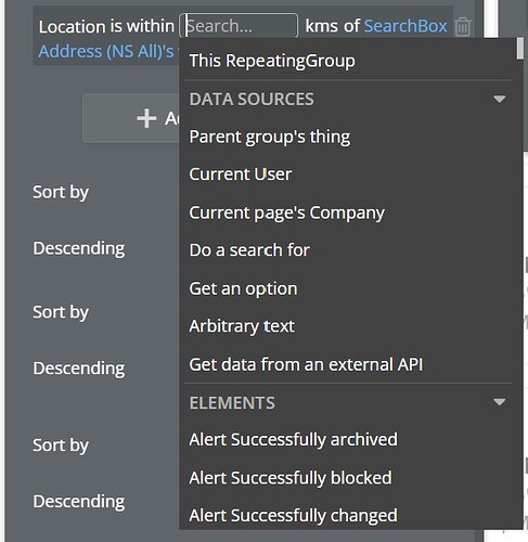

Currently, “Location” and “Radius” are saved under a data type “AR”. This is because users can create unlimited “AR”s, each with their specific Locations and Radiuses (each AR can have up to 10 locations and 10 respective radiuses). I was thinking of moving these two fields to User, but because theoretically there could be unlimited inputs I’m not sure how to manage them. So ideally they remain in the database under each AR.
The “Do a search for” is done in a RG, so each constraint needs to reference each thing’s fields.
Maybe there is calculation which can be done in each search constraint, to calculate the distance between “Location” and “Property address”, which can be then written in the search constraint as “Radius” > “distance(calculation)”? Then I could apply :merged with (to merge 10 “Do a search for”s, each for a different location)
That is fine, just look at the answer I provided and ignore that the data type is current user and instead reference your AR. It shows how to save the two fields onto a data type and how to use them in the search constraint for distance.
Or are you trying to do something else?
Sorry, I’m still quite new at this! This is exactly what I’m trying to do, however unfortunately the options don’t let me pick “This AR”. This is probably because the search is within a repeating group. These are the options I can see:
Yeah, this isn’t possible in Bubble directly on the DB query - it’s one of the limitations of Bubble’s search capabilities. (you can’t ‘self-reference’ items in searches).
