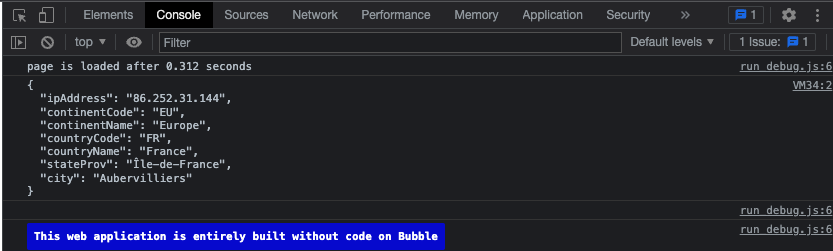

Is there anyway to extract the estimated City, State, country, etc from this?
Hi @tylerboodman :wave:
just remove .ipAddress from data.ipAddress
Screenshot 2022-08-31 at 19.03.36
The response will be like this…
Awesome, thanks.
