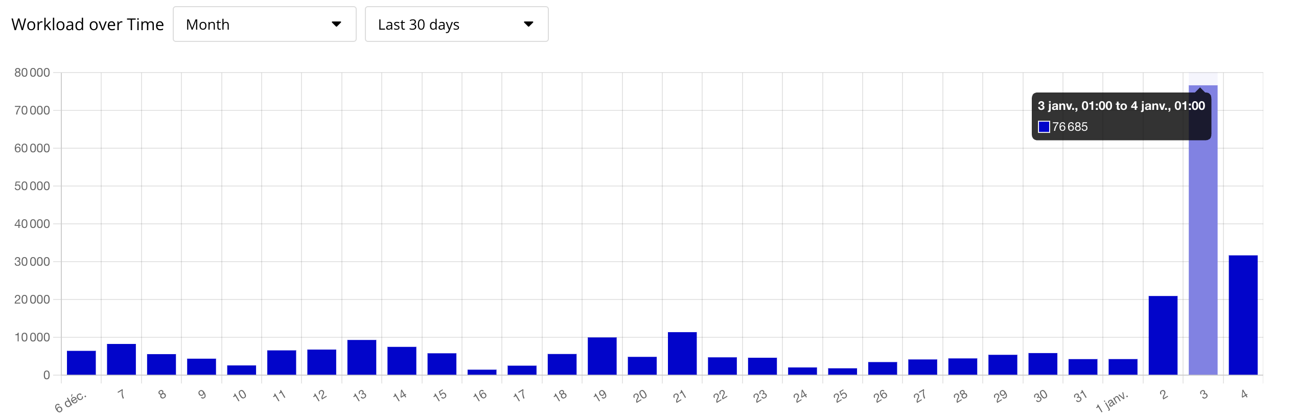

My Workload Units consumption exploded those last 3 days, without reason.
No real increase in page views (nothing comparable at least), and I haven’t changed anything in my app…
Am I the only one in this case or do some of you are facing a similar issue ?
I went from 4.000 WU/day in average to 76.000 WU in one day, without any reason…

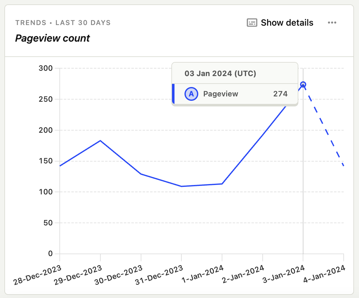

1 - I indeed have a spike in page views (and therefore in workflows), but that is not
I also see on Spike in my PostHog dashboard, which seems to confirm this (even though the count is a bit different)

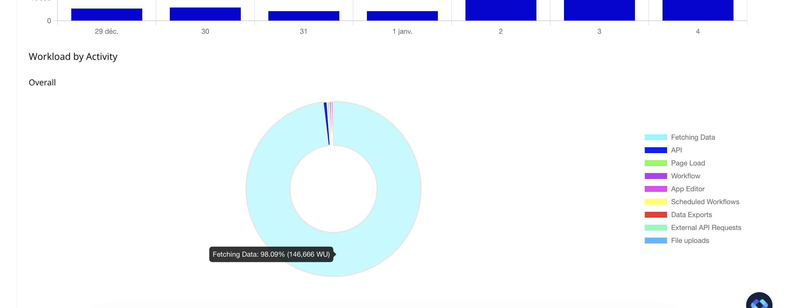

More than 95% of my WU Consumption comes from Fetching Data :
But !

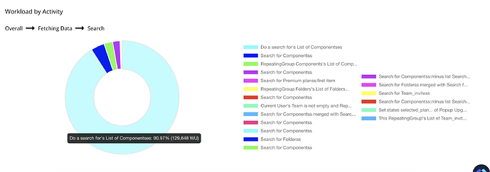

Over 90% of those Fetching Data WU come from a single search, which is made within the Fuzzy Search plugin (from Zeroqode).
The intesreting thing I already knew this plugin was causing quite a substantial amount of WU consumption, but it stayed quite reasonable and mostly, it was predictable enough.
The strange is that I already optimized it as best as I could by hiding it when the app is not being displayed, and only making it search something when needed. It didn’t help. I haven’t seen any difference in it WU consumption.
A few days ago, I tried to change its data source, to make take it take its data from a unique RG (I therefore only perform one search at a time on my page).
But it didn’t make any difference as well.
So either I’m not understanding how this plugins works, or there is an issue with it !
I’m going to send an email to ZeroQode support to let them know the situation and see if they find something.
In the meantime I’m gonna migrate my search to Algolia. This should drastically reduce my WU consumption. (I should have done this a while ago anyway, so that’s my bad)

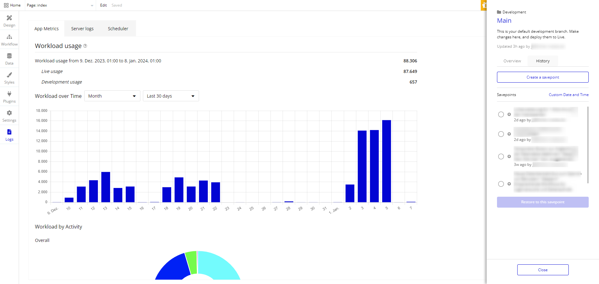

wow I just posted the same question! (sorry i didn’t see yours or i would have posted it here instead). my graph looks just like yours! Here is mine:
Like you, i’ve changed nothing in the app at all - and we’ve had no extra traffic…yet big wu increase last 3 days. So this is something fishy! Hopefully, it’s a bug at bubbes end that they can fix.

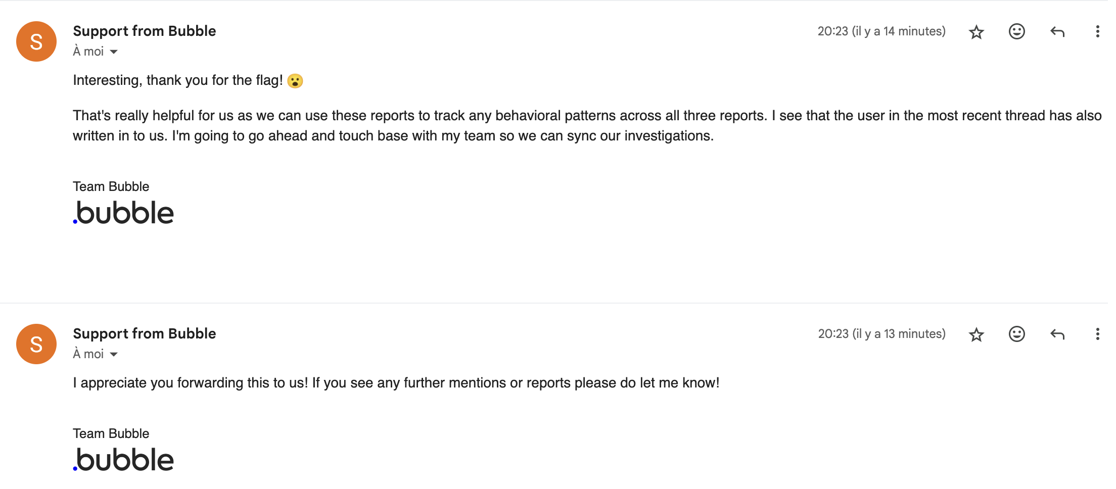

By the way, I’ve transferred your post, and they seem to understand something’s not right, so they are working on it ! Now it’s just a matter of patience.
They’ll probably reset our WU or make a commercial gesture so that’s alright I guess haha :slight_smile:
