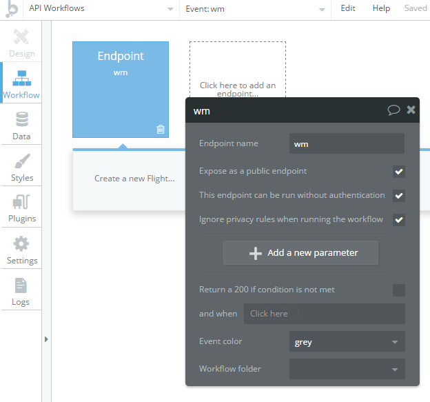

What I’m struggling with is - how do I connect an external service to Bubble, so that the external service can post to my App hosted in bubble. Here the call is initiated by the external service.

What I ended up doing is this:
I’m using Zapier to convert the XML into JSON and send the JSON to bubble.
Based on what I have seen and tried, bubble seems capable of parsing a JSON.
This worked for my initial requirement - parsing a pretty flat JSON file and creating a thing.
However, please note that there is a bubble limitation - it cannot parse multiple instances for a thing in a JSON payload. See my forum posting on this topic.
@csblack - you can define a webhook in zapier for this. Zapier will be able to process the XML input and get the key-value pairs. You can then customise the zapier ouput.
