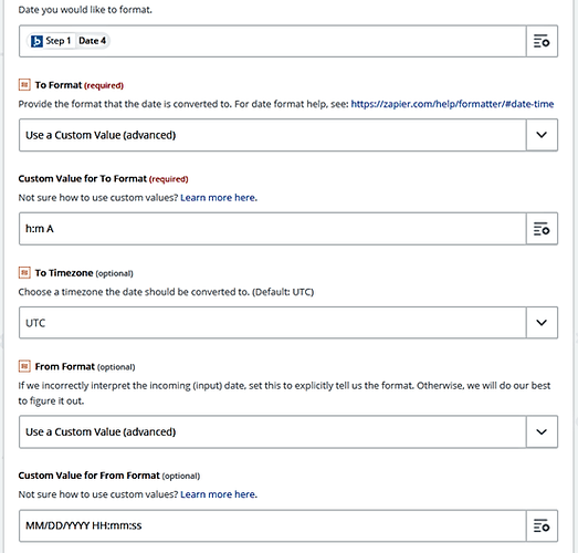

After chugging through my app to finally get it working, I’ve managed to integrate it with my Google sheets without any trouble. However, the times that I’m recording on my app and then transferring into my sheet is coming back as an entire data and time with seconds. I just want it in the format h:mm AM/PM.
I’ve tried formatting the sheet, but it overwrites it. I’ve tried using the zapier formatting app to try and process the dates before going to the sheet and can’t seem to get that to work either.
Any help would be appreciated!

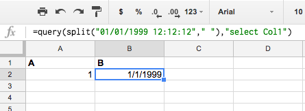

Here’s a trick. Instead of just sending the output of the zap to Google Sheet, send this equation instead:
=query(split("[date]"," "),“select Col1”)
where [date] is date sent by Bubble.
Basically, that tells the Google sheet “Take this string, find the space, then only keep everything before the space”. You’ll then up with just the date on your Google Sheet.
So setup like this:
And you’ll end up with this:
Hope that helps!
