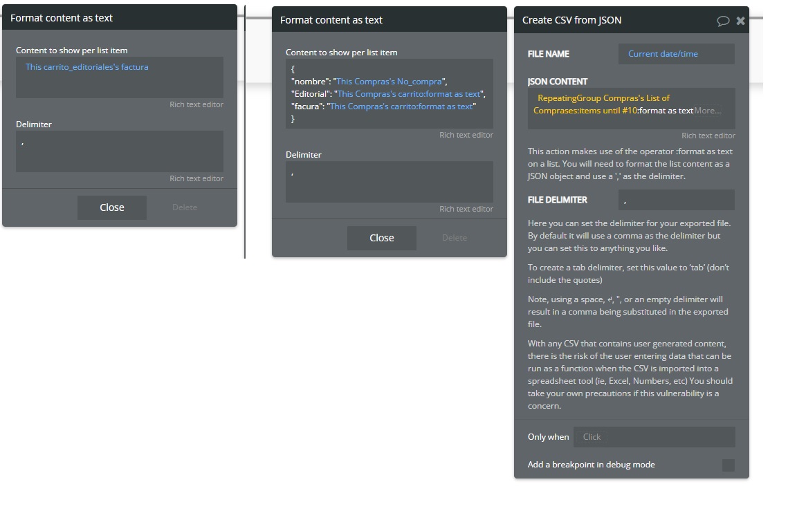

I am exporting and a field is a list of products.
How can I make the exported document jump in rows each field of the list.
I only get comma delimited
this is the fw i have
You have to base the export around the list of products rather that the thing that contains the list of products.
okay
What a shame to bother, can you give me an example of how it would be? the truth is not clear to me.

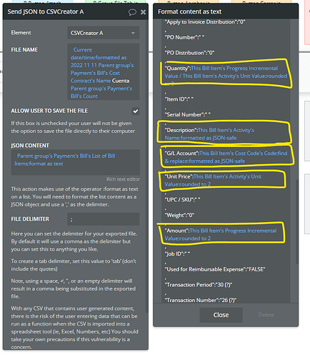

Hello everyone, and special thanks to @eli for this great plugin. I have been using it for a couple months with great results. Thank you!
Would it be possible to add extra lines to the file, and have those lines have values in certain columns? I have a list of items, each with its quantity and cost. I would like to add a line a for sales tax at the end of the entire list of items, and have that sales tax come from a field in bubble as well. Is this possible?
In yellow I mark the fields I would populate. The ā€œDescriptionā€ would say " Sales Tax", and the ā€œValueā€ field would have the Bubble field’s value for that orders sales tax.
Thanks!
