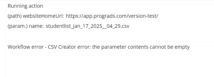

I’m having the same exact problem. It worked two weeks ago and now I guess those timeouts are killing it. My log gives the same result:
@julian.mcneill @eli
I’ve tried to move the create csv from base64 into yet another (step 4) api workflow, but I don’t know if the same problem exists, where the CSV from JSON action doesn’t finish before the 4th workflow is scheduled with the file (parameter) therefore not being passed from step 3 to 4.
In fact the problem stays the same. The 4 step process works, but the same timeout kills it on the Create CSV from JSON step.
@prograds @julian.mcneill You are probably encountering the same issue where there is a timeout assembling the JSON. We do return an error message on the action if we encounter an error so you might look at creating a log in your database that stores the all the results of the Create CSV from JSON (SSA) including error, base64, etc.
Also, keep in mind that if it works on 250 in dev or a subset in live but not the full list of records, you may have data that is breaking your JSON. This would be exposed in the error message that is returned. In this case you’ll need to be sure you are using format as JSON-safe on any values that could possibly contain a breaking character such as a double quote or new line.

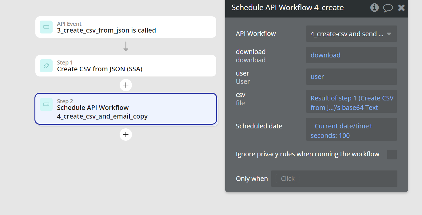

Don’t you think the solution here is to build the JSON and then schedule the next step for maybe 2 minutes later? Is there a way to do this, so that the base64 text file is save on the download and then it can be used in the email step? Right now I have this:
But because the csv file is there, this workflow wants to schedule this and send that file to the scheduled workflow, but the file doesn’t exist yet because the Create CSV from JSON step isn’t done yet.
