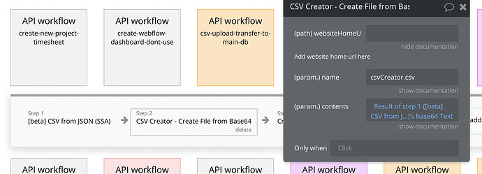

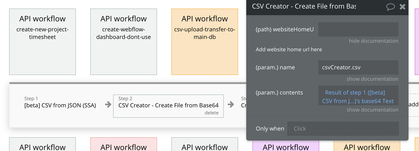

I am trying to use the plugin in the backend workflows.
Step 1: I used the “[beta] CSV from JSON (SSA)”

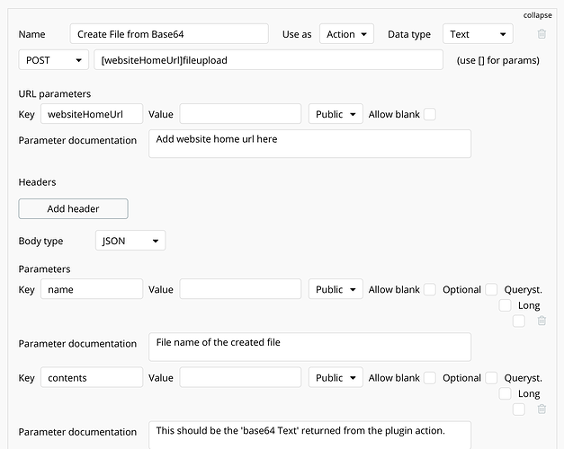

Step 2: I realized the output of Step 1 is Base64 file. So I used the “CSV Creator - Create File from Base64”

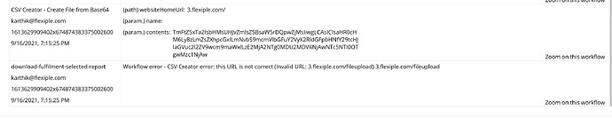

However, in Step 2, it asks for the websiteHome path. I am not sure what to enter there.
I randomly tried entering the website url of my Bubble app and it gave this error

@karthik, you should use the dynamic expression website home url. It will create the file in the file manager of your app.

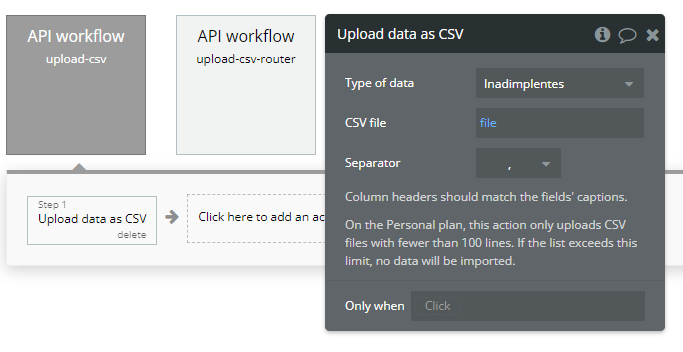

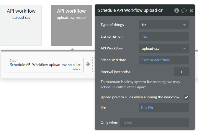

Hi Eli, how are you?
First, thank you for your time and dedication to creating this plugin.
I would like your help, I’ve seen your video tutorial about the plugin several times, but I understand what I’m doing wrong, I’ll leave the images of the properties below, I even named it the same way you do, but for me it doesn’t run, it just divides the files do not matter to Bubble.
Field for Types
Plugin Properties
API Workflow Properties
Workflow Router Properties
Upload-csv Properties
Workflow upload Properties
Upload data CSV Properties
Debugger
As you can see, the debugger doesn’t start the Workflow API on the backend. I use the Personal Plan and it is active in the settings.
Thank you for your attention!
