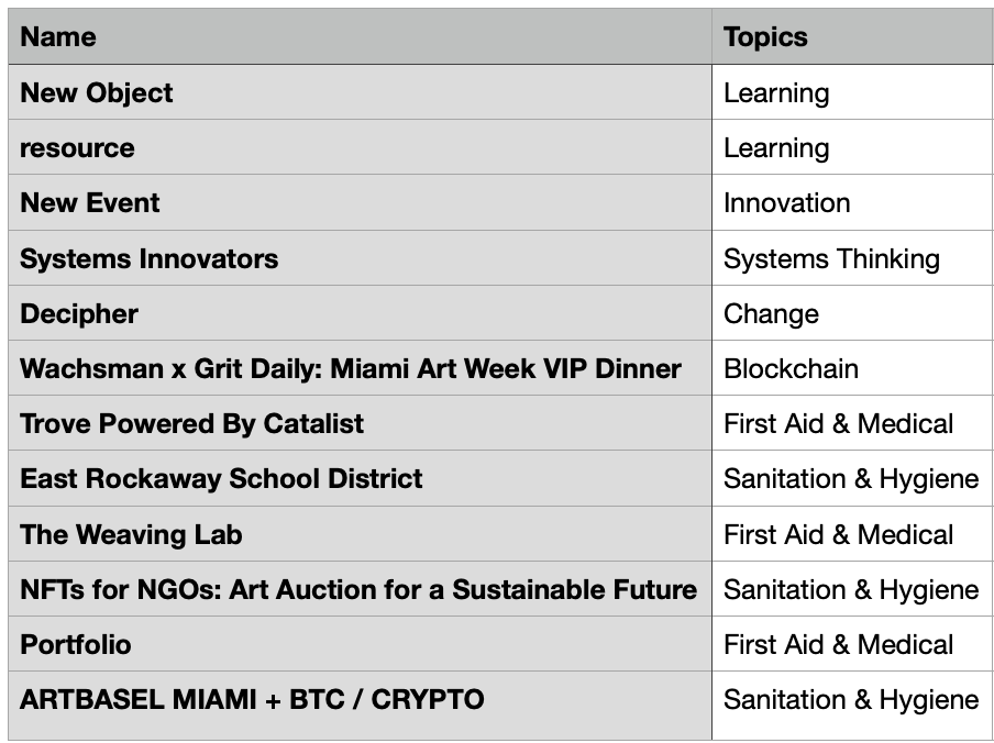

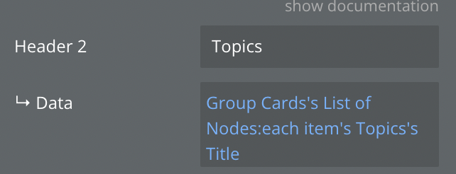

When i try to download a list of Nodes’ Topics, the .csv only shows the first Topic of each Node.
All of these objects have more than one “topic” that should be in each cell in the Topics column. I want it to show in each cell: “Topic 1, Topic 2, Topic 3”.
Is there a problem with displaying lists in each cell since it would mess up the csv file if there were commas? Can another deliminator be used? I can’t format as text since bubble expects a list of texts, what other way to format this could get the desired outcome?
Here is the setup:
Screen Shot 2021-12-09 at 5.36.23 PM

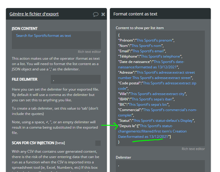

My csv is correctly output, but with an empty field, where data is a list from another datatype (statut-changements).
What do I miss ?
thks !!!
Hi @Sarah_Esteve,
The field you notated is only a single item. It still should be exporting though. Is there data for sure being returned after the list is filtered?
@vincent.l.arena The ‘Create a Dynamic CSV’ action does not support exporting lists. You will need to use the JSON to CSV action for that functionality.
oh I understand well, if I use first item, no need brackets.
It works fine now. thank you !

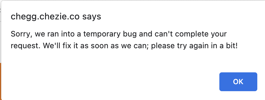

Hey @ccatalano - did you figure this out? I’m getting the same error. It works on other exports (smaller lists with 10-15 items) but for exporting a list of members where there are 150+ line items, I get that error.
This looks like it’s been asked a couple times but I don’t see a response.

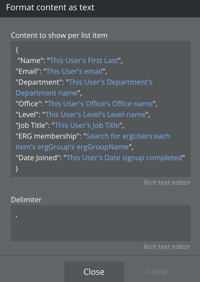

Is there a limit to the number of items that can be exported? I get this error for anything more than 99 items:
I use the plugin in several other places of my app and it works just fine. Here’s my set up:
If anyone has a workaround for lists with more than 100 items, let me know!
hey @eli was wondering if you had any comments or suggestions for exporting lists larger than 100 people? I get an error whenever I try to do that.
Thanks again for this plugin! it’s been a lifesaver
Hey Toby, it should definitely do more than 100 rows but it will time out on the front end if it takes longer than 30 seconds to retrieve the data.
Are you pulling in a lot of related records?
Oops just saw the image above. The search on ERG Members is probably causing issues. Try removing that search and see if it performs better.
