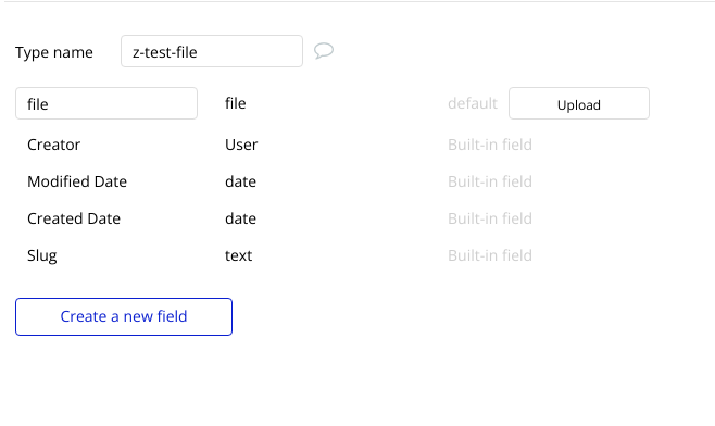

I really struggled with this too just now and after reading the response I thought I had it figured out. Still ran into a bunch of issues with what I was trying to do, which was to first save the file to my DB as an entry on a datatype and also send it via email as an attachment…neither were working until I saved the file to my DB with the find and replace.
Screen Shot 2022-04-19 at 12.09.24 AM
Now I can create the file via backend and also save it properly and send it via email.

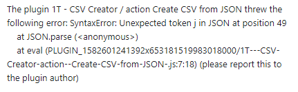

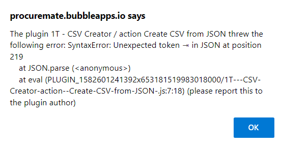

Does anyone know what this is?
I got this same error message for 2 separate JSON to CSV plugins
Screenshot_1062
I had a similar problem.
After spend several time of research, I found ‘tab’ in data.
So I change the data to ‘some_field:trimmed’. Now It works very fine.
Just in case this isn’t intuitive to anyone, when using :format as JSON-safe, you need to remove any double quotes you had there before, as this function will wrap your text in double quotes!

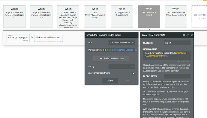

Guys I need some help here. When i put a date in the search like below, I get an error. when i take it off, the csv displays without any problem. (also see error below) . It works fine in dev mode, but throws the error in live mode
Here’s the error i get.

same issue there. I’ve searched for the " caracter in text but not found. @eli maybe you’ve an idea?
