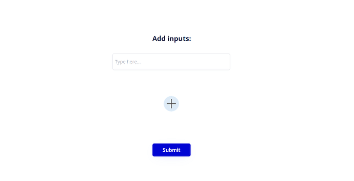

I would like a new input box to appear whenever the user presses the ‘+’ button. The new input will appear directly under the previous input box each time. The user can then press ‘Submit’ to submit all inputs they have entered.

‘Adding’ multiple inputs is relatively simple in Bubble…
Using a repeating group is the correct thinking… of course it depends on many factors of what you’re actually trying to do as to how to actually go about doing that, but here is a simple example, using a list of numbers as a data source (but in your app, it could be a list of anything).
Add Inputs (bubbleapps.io)
But, the question of how to access the values of those inputs, and use them in a workflow (or elsewhere) is rather more complicated, and something that Bubble doesn’t make easy…
So it depends on exactly what you’re intending to do with those inputs that will determine your overall approach here.

Actually Adam,
I have now added the toolbox and figured out how to do it :slight_smile:
Then next step will be for me to figure out how to upload the list. I am tipping I just need to add a workflow to the submit button?
