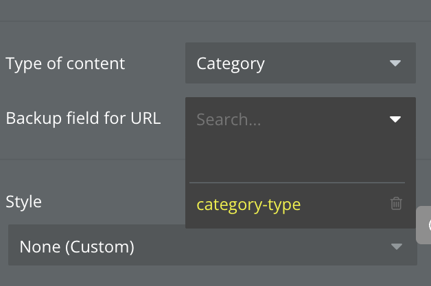

The page name is “Offers”, and the purpose is to have this one page pull data based on the category you click in the Header (IE: Tech, Fashion, Entertainment, etc…). Right now the “type of content” is set to “Category” as it is a Data Type. The ultimate goal is to make it say “www.example.com/offers/[Category]” ([Category] being tech or fashion or what).
Mainly confused on how to make [Category] display the category of offers that are being displayed.

With the setup you explain now, you can set page content type to Category. Then make sure all categories have a slug value. Then when filter the search reference current page category as filter value

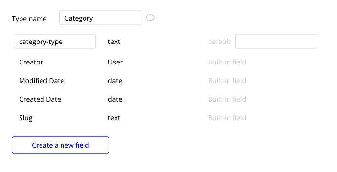

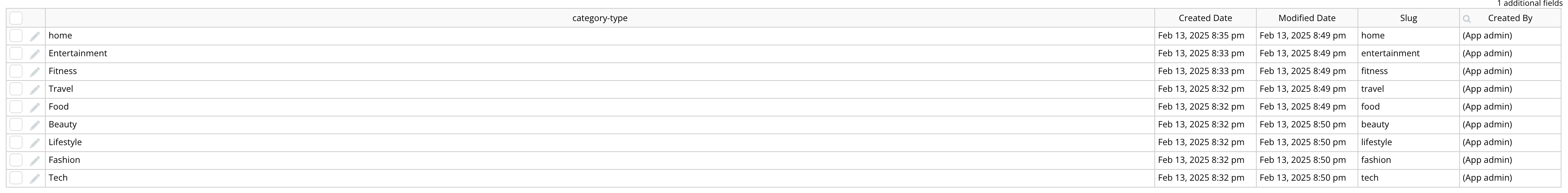

Last question - I hope - how does one doe Filter The Search to make it filter that specific category chosen.
Also, this is how it’s setup:
