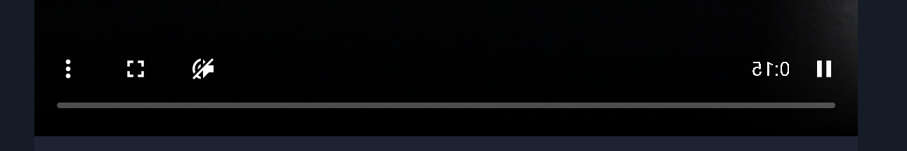

Now, my only issue is that the camera stream is playing me my own sound, how can I turn that off?
What I find interesting is that it seems you guys thought about this, when I show the controls of the video player, I can see that it’s mirrored and the audio is turned off, however my own audio is still playing.
